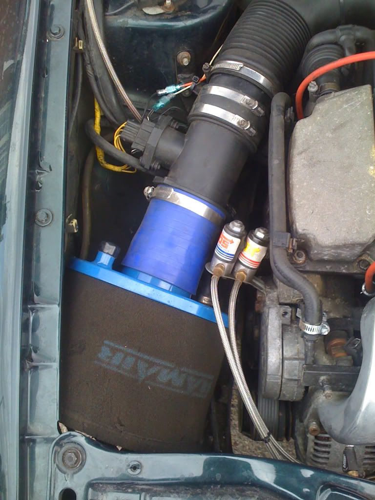

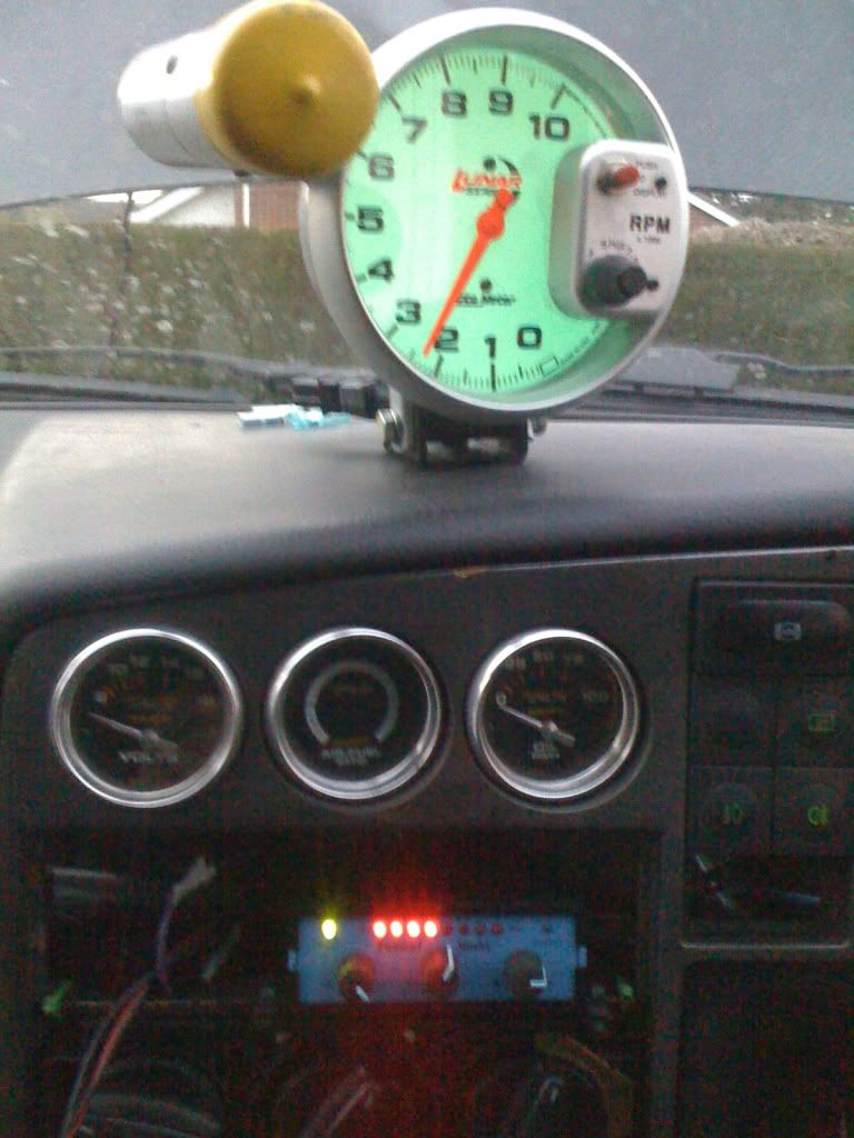

    the Brooksters twisted sanity nitrous controller now fitted. it would appear I am a numpty...I never quite understood the NOS controller, it all makes sense now...apparently the build up time sequence starts again every time you come off the throttle......so i'd got it set on 6 seconds...when I'm only in each gear 3 seconds...which means it only ever deliver half of the full 150bhp shot, apart from the run where i short shifted into 4th and held it, and unsurprisingly that was the run when it felt insanely quick and did the 107mph. so now I know what I'm doing i should be able to set it up better and get some proper results.

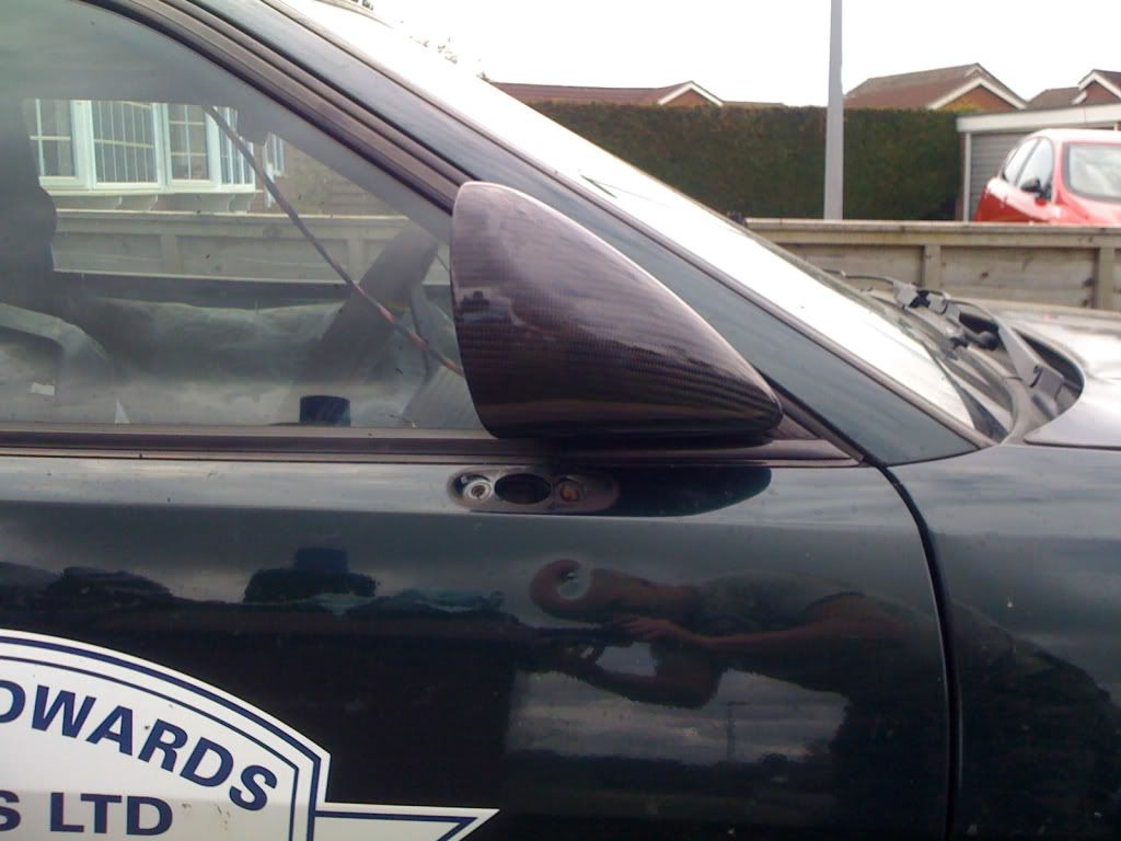

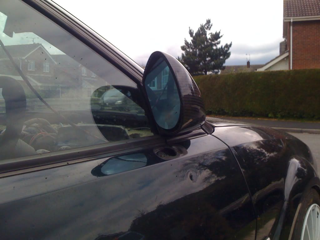

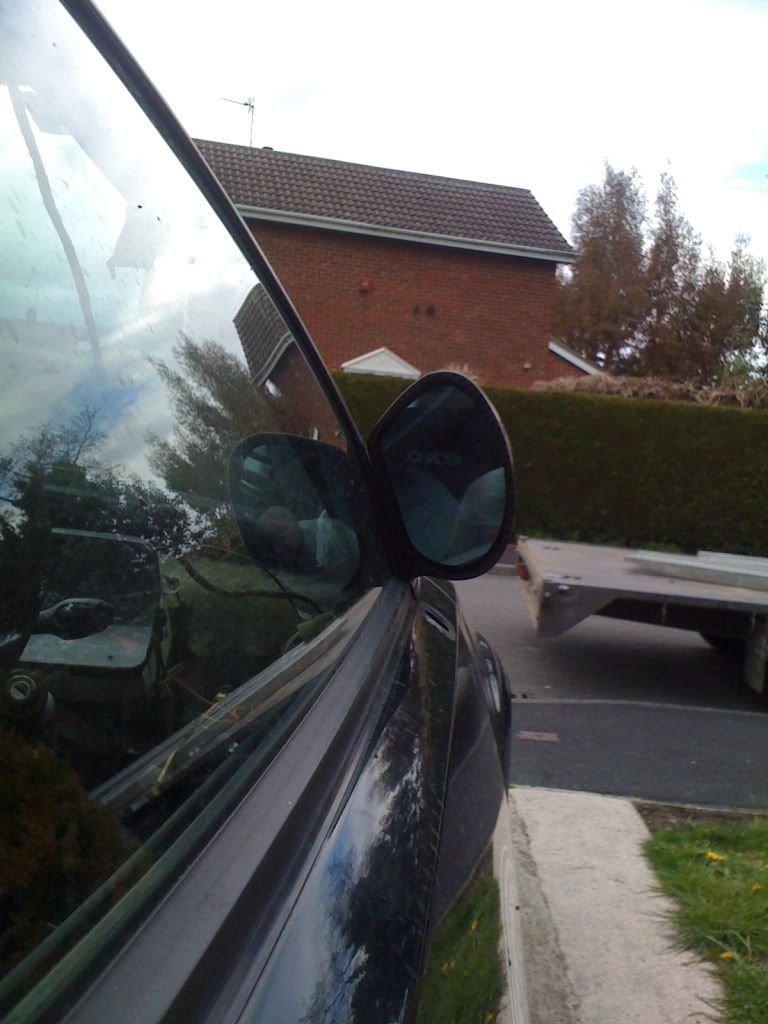

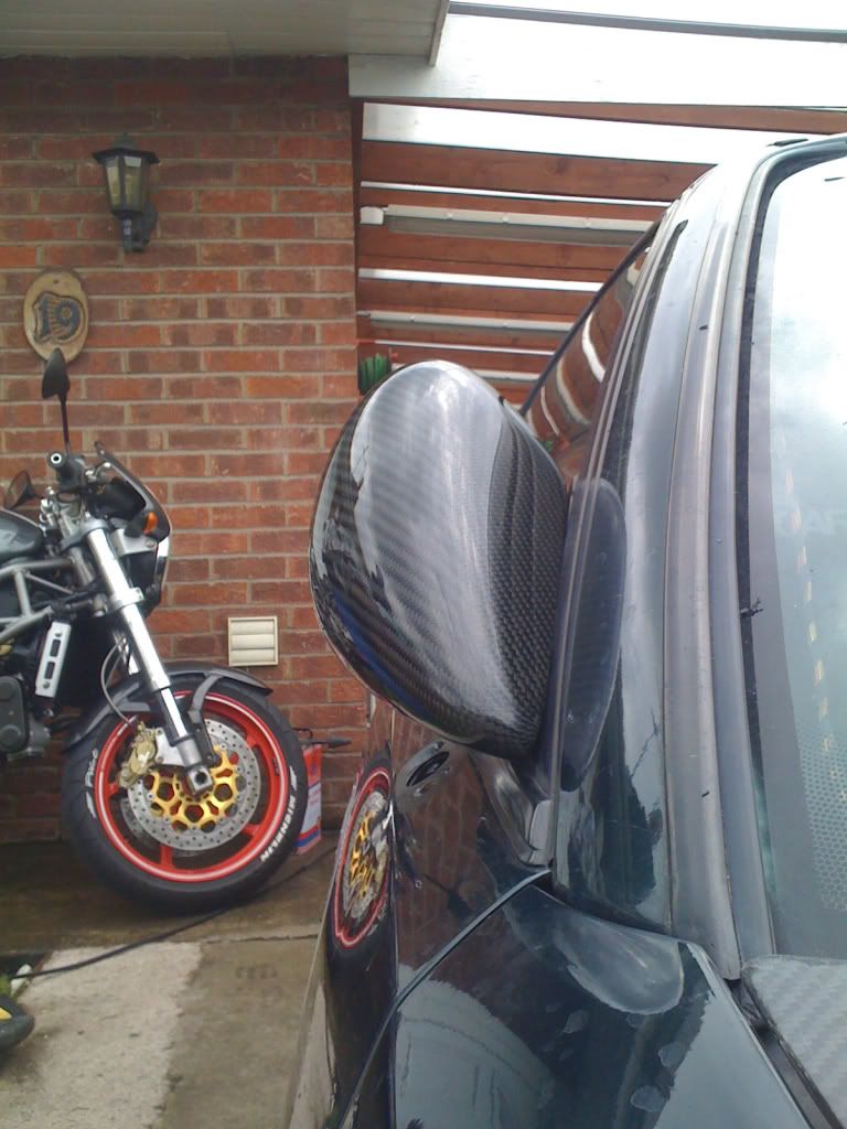

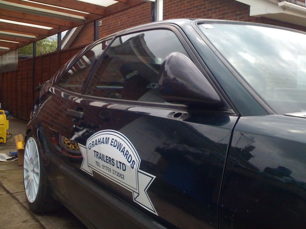

    I fitted the carbon Subaru Impreza WRC mirrors today. I wasn't so sure about them at first, they look a bit wierd, a bit like a spaniel on a rollercoaster. but I love them now. They need a bot of work to get them to sit flush, I just didn't want to mess about in case I didn't like them or couldn't see out of them and needed to sell them on.
    I think I found out when it had no power above 6k too, the old K&N was totally clogged up with filth and dead flies. Binned and replaced with a good old RamAir Pro Ram.
    Car now has a dashboard. I've fitted my autometer gauges and rev counter too but just ran out of time to get them wired up. I'm part way there, might get them done at the track tomorrow sometime.
