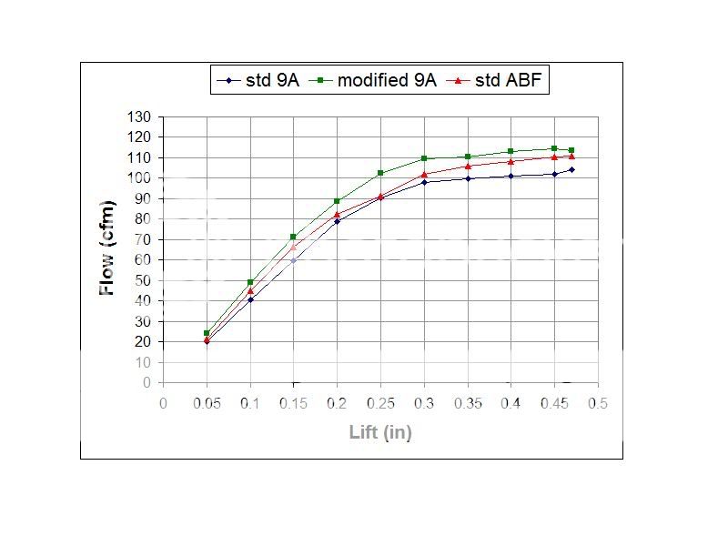

    Since you've done all the hard work I thought I'd help out :) I need to see graphs really to take things in so here we go...
    Lift (in) std 9A modified 9A std ABF
    0.05 20.2 23.9 21.3
    0.1 40.5 48.8 45
    0.15 59.5 71.1 66.4
    0.2 78.6 88.7 82.2
    0.25 90.4 102.4 91.4
    0.3 98.1 109.6 102.1
    0.35 99.9 110.5 106.1
    0.4 101 113.1 108
    0.45 102 114.3 110.3
    0.47 104 113.7 110.9
    Keep up the good work, its rare you get to see hard data to back up modifications so thanks!

    Good man..many thanks.
    I was hopeing someone would do that..saves me scanning in since the graph off the flowbench at the end.
