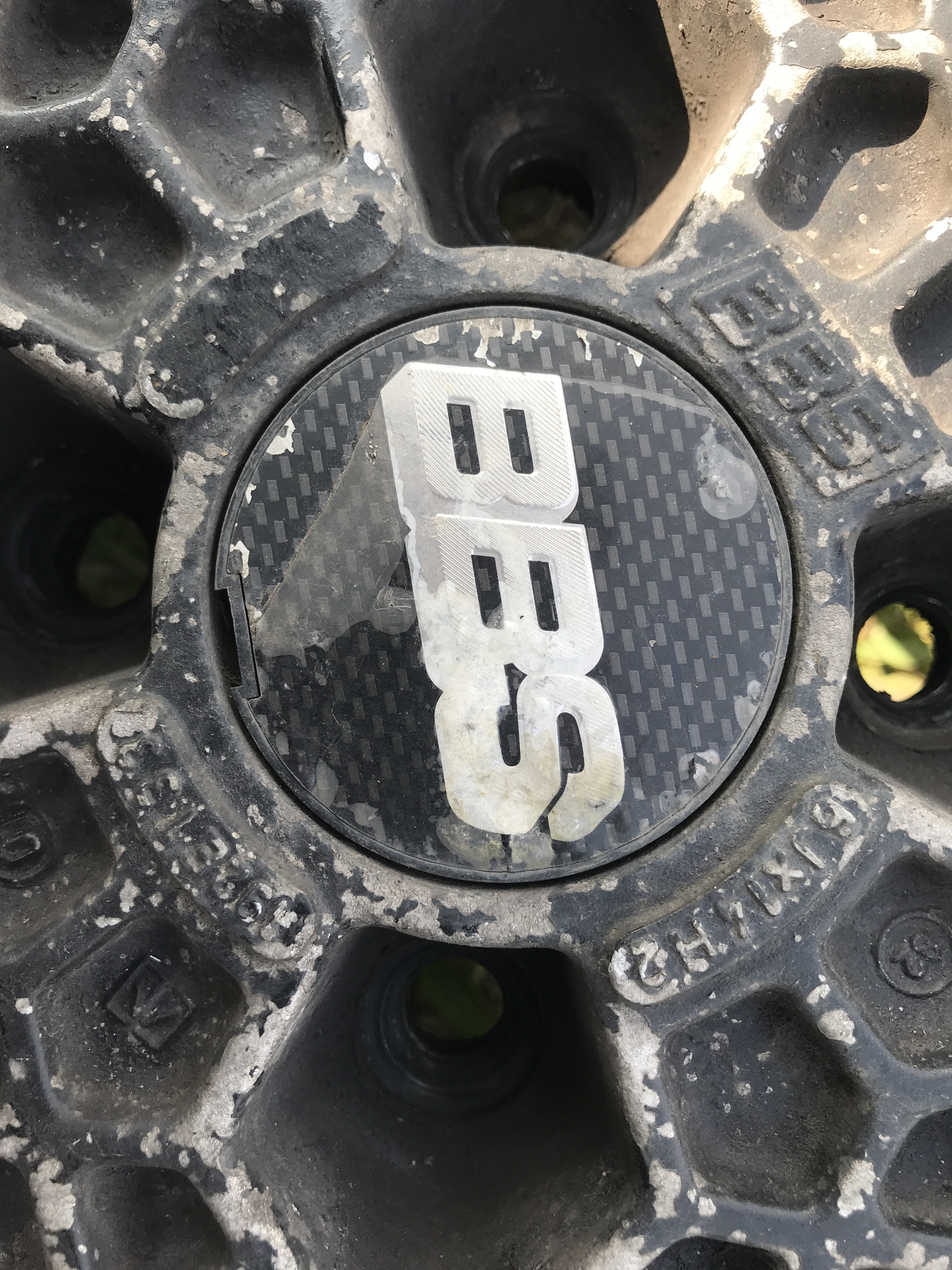

    Hi,
    The wheels i have on my 91 big bumper gti are BBS RA alloys - marked 6Jx14H2 192ET33.
    Are these stock size wheels and also what would be the stock tyre size for them?
    I'm planing to get them refurbed and tidy them up.
    Thanks, Mike

    185x60x14

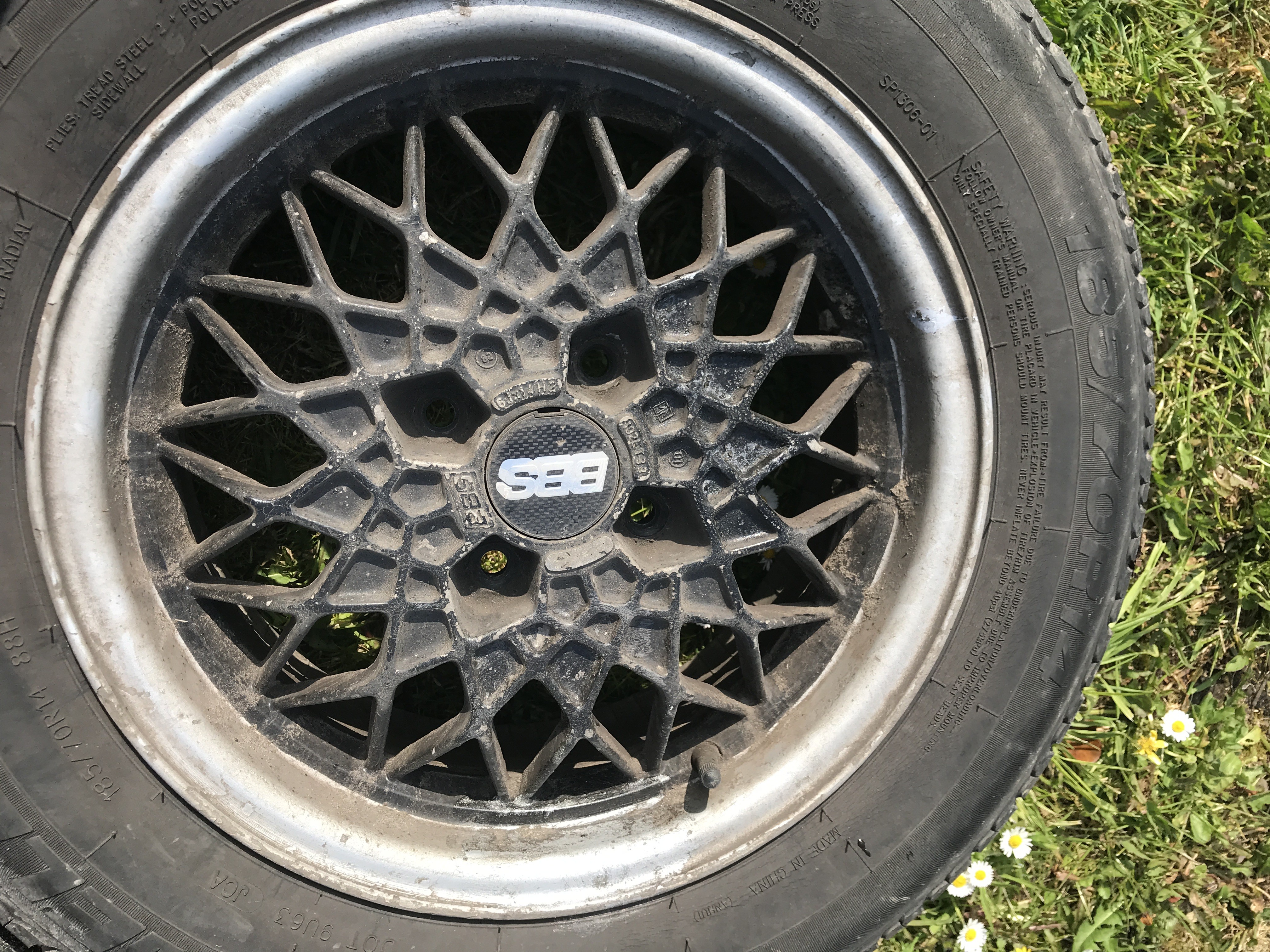

    Cool - thanks - they originally (on this car!) came with a mixture of tapered and radius bolts courtesy of the previous owner - which ones should they be - i've had a look at the wheels, but its tricky to tell as obivously they have had the wrong type stuck in some holes.
    3,576
    These are aftermarket, VW only offered BBS RA wheels in 13" or 15". They may have been ordered from the VW accessories catalogue but without the original documentation its impossible to know for sure. One clue would be if steel wheels are shown on your options sticker in the boot, normally a GTI would have alloy wheels as standard but when dealer accessory wheels are specified the factory builds the car with steel wheels then the dealer swaps them over once it arrives. Can decode your boot sticker here:
    https://clubgti.com/forums/index.php?threads/vag-option-codes-decoder-list.283422/
    as for wheel bolts the dealer accessory 14" BBS RA wheels need M12x1.5x40. IIRC they should be ball seating but squidge a big blob of blutak in a wheel bolt hole then see what shape it comes out

    Here are mine -

    Yes - I had a closer look at them and I’m pretty sure they are taper bolts
  11. rubjonny
    3,576
    taper bolts mean they are originally specified for a BMW or aftermarket sale, 14" BBS from the dealer accessory catalogue would need ball seat bolts.
    bit of a pain, meas you have to have a set of standard bolts for your spare wheel as the BBS ones would be too long and in the case of non vw accessory incorrect taper!
