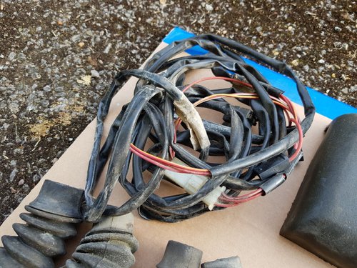

    hello again,hope your well, just a point before i start ripping the foot well apart looking for the white three pin plug does this apply to the ce1 (with hazards on dash board )not steering wheel, just thought do you know whether it is negative or positive trigger, what are the pile of wiring for,thanks

  9. rubjonny
    The main cl wiring is the same for both, the only difference is where on fusebox the live feed comes from:
    https://www.clubgti.com/forums/index.php?threads/fusebox-faq.219775/
    It's a positive trigger system so live from fusebox to cl switch, then live from switch to either lock or unlock pin on pump in boot, and pump earth's in the boot
