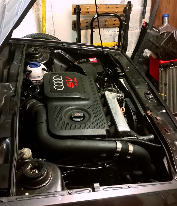

    Hi, i thought i'd post my progress as i've been looking at this forum for a while and the facebook page and thought i'd share my journey on my MK2.
    well i picked up a 1991 8v back 2 1/2 years ago.

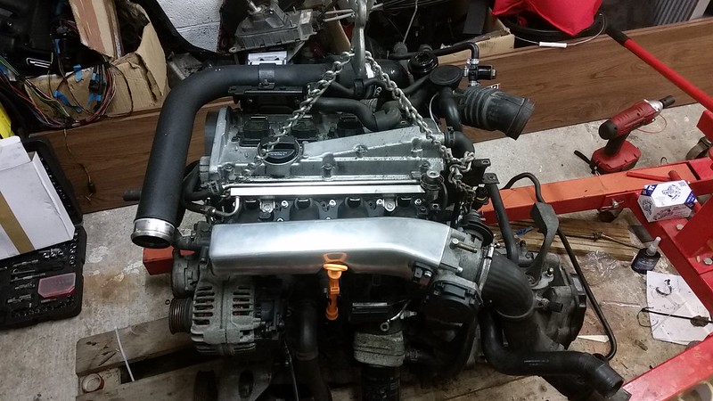

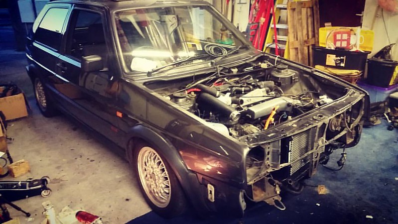

    I drove it about for some time and then decided on some maintenance and a change to 20v. i've skipped a lot but here's some of the journey.

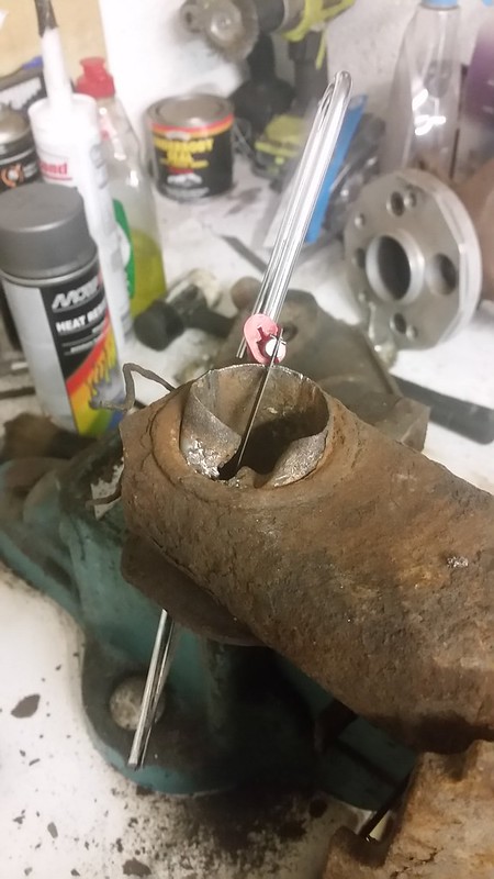

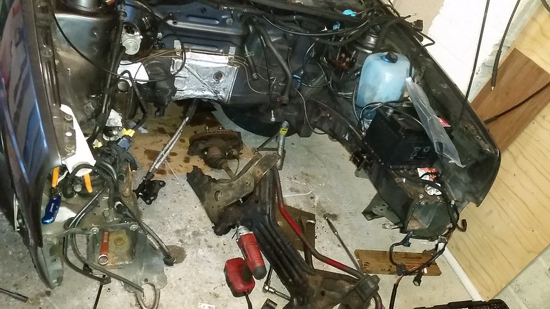

    The front drivers side wishbone joint was looking a bit sorry for itself :o
    so ive added on some S2 twin pots

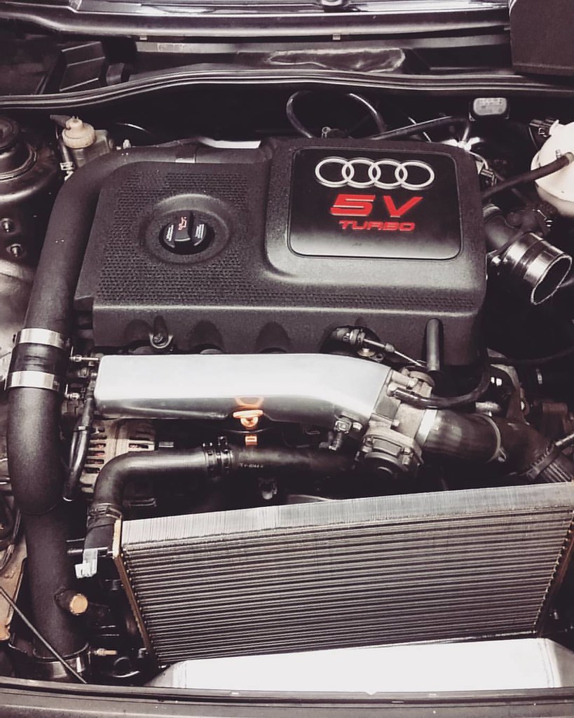

    changed the charge pipe setup for that of a k04
    new genuine mounts:
    got it all in the car
    a couple of nights of work and its back like this:

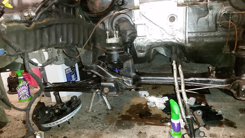

    just loosly put in the new subframe while i clean up the engine bay and the old power steering rack
    the new daily :violin:
    also ordered a new trackslag exhaust , the slanty tip one to look OEM.
    its no longer my daily driver but also not a show car
    this was from 2017 Volksfest
    Cooling sorted, plumbed, bled..ready to drive! now for some dry weather

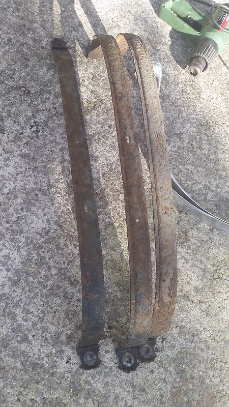

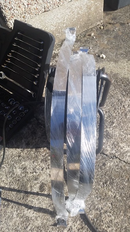

    i replaced the fuel tank straps with new stainless ones :
    [​IMG]20171022_144829 by Cragmire40D, on Flickr
    [​IMG]20171022_144839 by Cragmire40D, on Flickr
    the mounting points were very clean

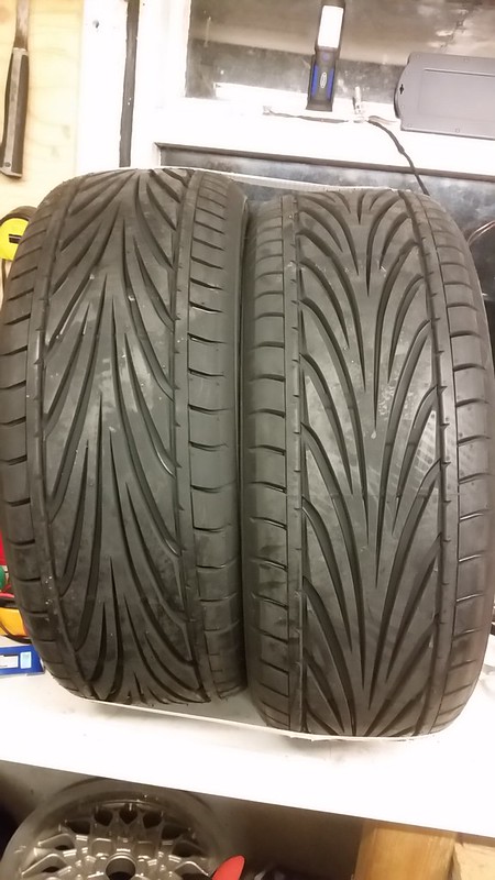

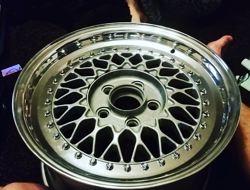

    had the original RA wheels refurbished and new tyres all over

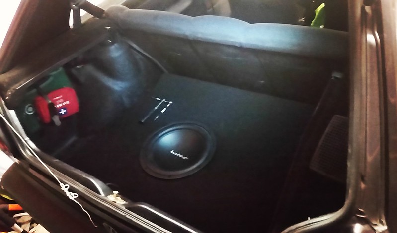

    Built a false floor for a bit more sound
    [​IMG]IMG_20180122_200616_046 by Cragmire40D, on Flickr

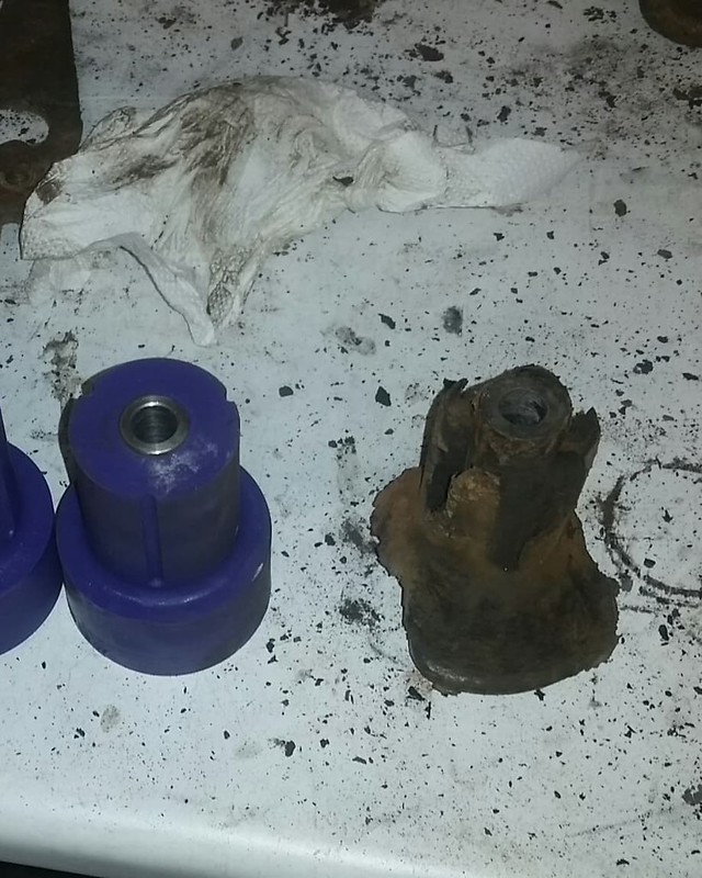

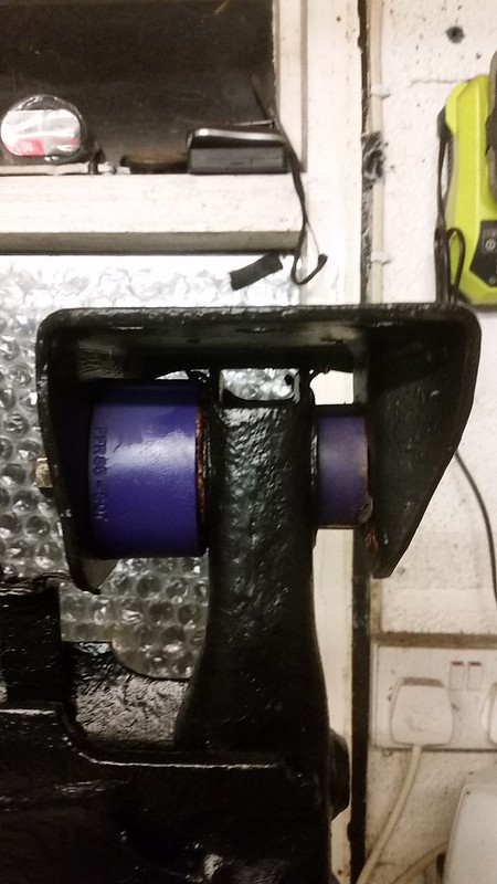

    Decided to move away from the tapered bearing setup and go for a 6N2 GTI rear setup
    [​IMG]20180115_112944 by Cragmire40D, on Flickr
    then got excited and decided to just refurbish the whole rear axle

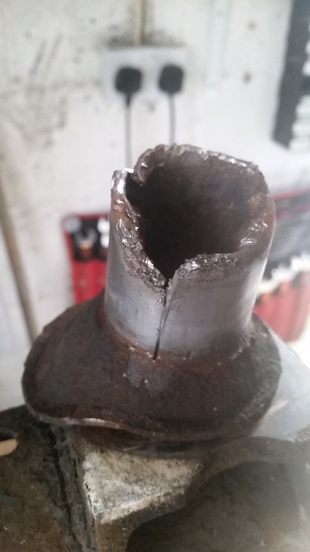

    Got a snapped bolt :(
    [​IMG]19905182_10156238860064258_4425863930378189923_n by Cragmire40D, on Flickr

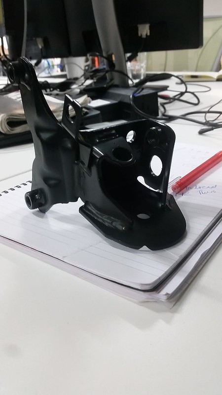

    cut out the old bushes and housings
    [​IMG]20180203_223730 by Cragmire40D, on Flickr
    [​IMG]20180204_140736 by Cragmire40D, on Flickr
    Old bush vs new
    [​IMG]IMG_20180122_200839_578 by Cragmire40D, on Flickr

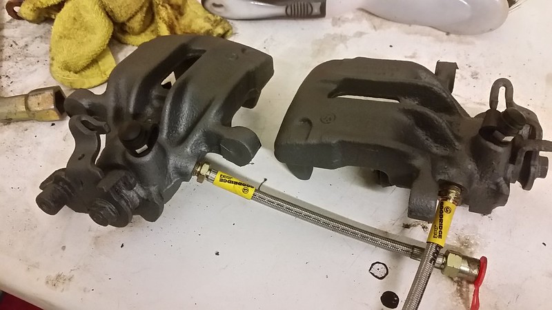

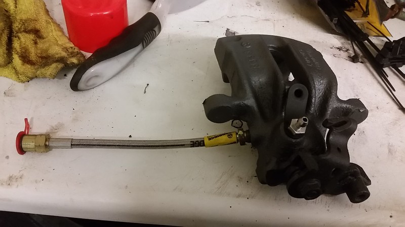

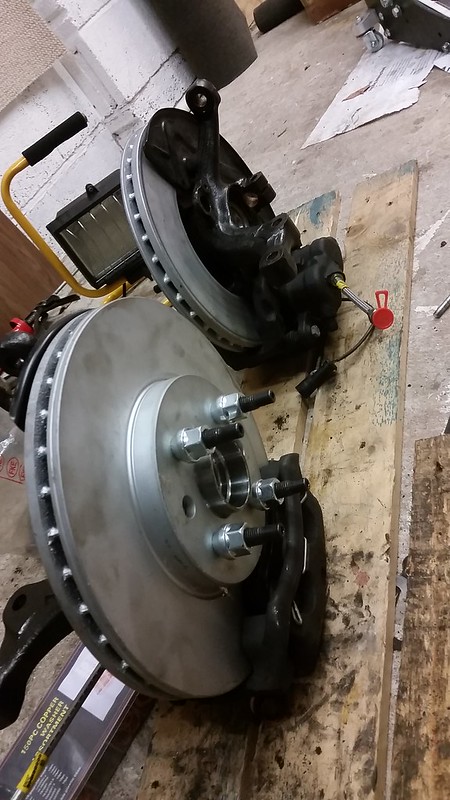

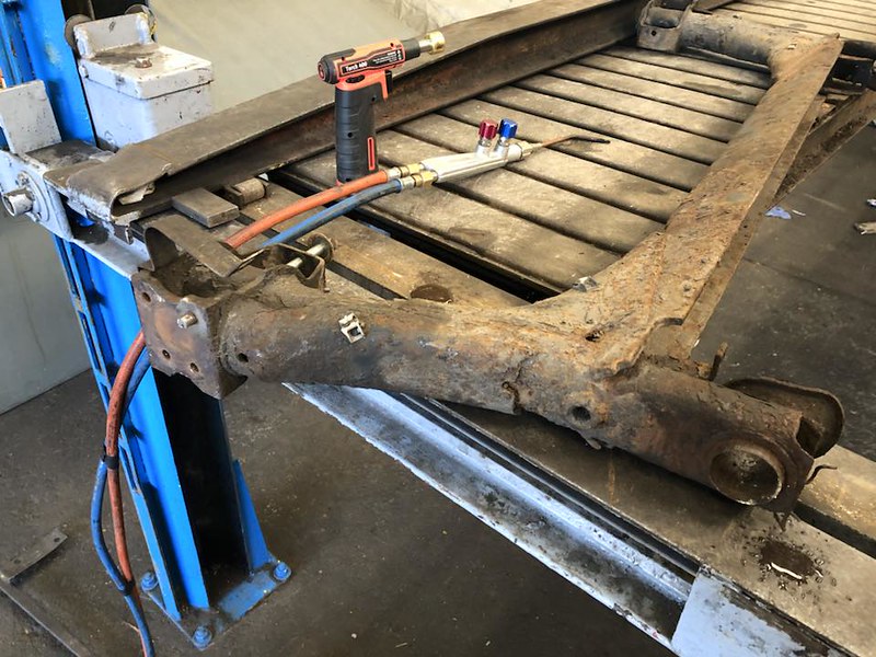

    Refurbished the mk2 rear calipers, adding stainless nipples with new covers and painted in Dark Anthracite which i will paint the fronts in too
    [​IMG]20180206_182456 by Cragmire40D, on Flickr
    [​IMG]20180206_182202 by Cragmire40D, on Flickr

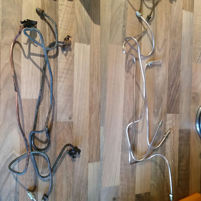

    Brake lines replicated

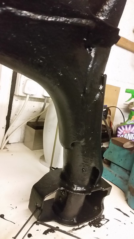

    rear beam blasted

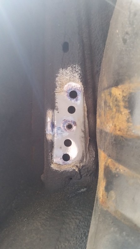

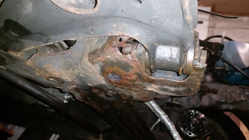

    Bumper removed and checked the area, looks really good
    found a couple of little problems:

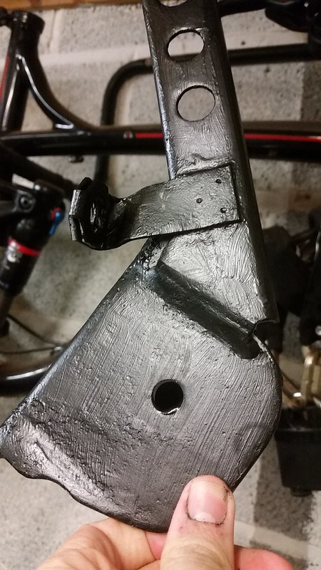

    loose underseal removed and area prepped for new

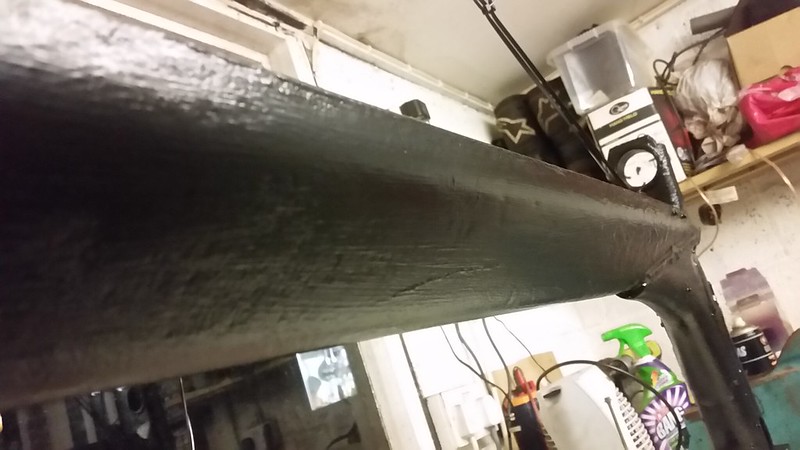

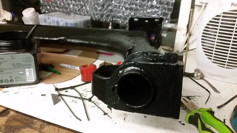

    Rear beam and brackets painted with Raptor Paint
    https://farm5.staticflickr.com/4650/40450751952_030ddbeede_c.jpg[/img]

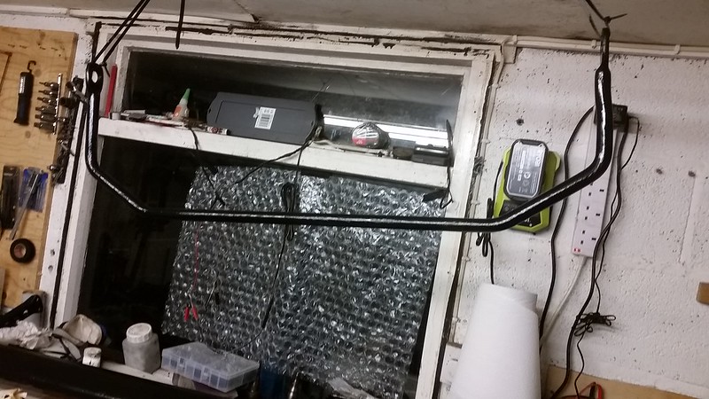

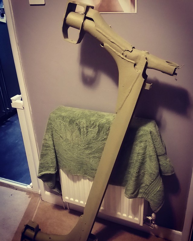

    Stripped down the rear ARB to bare metal as it seemed to have some worming under the powdercoat, painted with etch primer then Upol-Raptor, let it all cure for a week and i re-fitted it all with all new bushes.
    Thats a summing up of progress so far, lots more to come

    What do you think of the Raptor? I've gone off powder coated parts, especially suspension...
    I'm more inclined to use the likes of Owatrol and or Por15 now.
    But I've heard Raptor is very tough.
  6. cupracraig
    cupracraig Paid Member Paid Member
    Jul 14, 2015
    380
    South West
    My initial impression is good. Its quick to activate so you have to be fairly quick when applying. I brushed it on and was pleased at how it applied, if you have access to a Schultz gun then that would also work very well. Por15 and Raptor were my choice for coating and Raptor actually came out cheaper and with better reviews at 21 delivered for 750ml and the 250ml activator.
    I tested the raptor on the work bench and its really really tough after 7 days, it took some elbow grease to scratch through it with a flat head screwdriver on a single layer, so the 3 layers should be more than enough to protect.
    The 1litre kit has been enough to do 3 coats on the rear beam, the beam mounting brackets and other associated parts.
    Remember to split it into 3 lots when painting i.e. 3 x 333ml (250ml Raptor + 83ml Activator).. if you mix it all in one go then it will cure and lump up in your bowl. So by splitting into 3 lots, you have time to work with it. it generally is touch dry in about 20 minutes from painting it on. then you can go over it again. But be sure to leave for 7 days to fully harden.

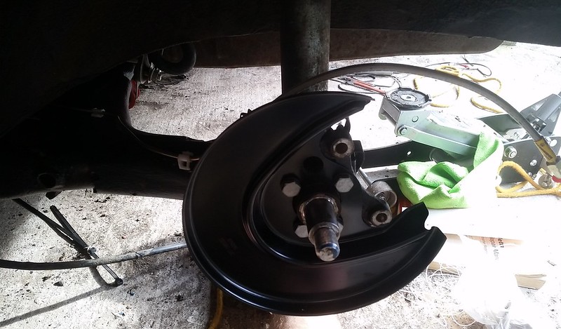

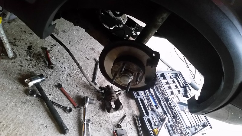

    Very fustrated this weekend that the caliper carrier bolts didnt arrive on Friday, so once i had replaced the rear hard lines i bolted up the stub axles and the dust shields and put the kettle on.
    really annoyed as i could have had the car back on the ground this weekend.

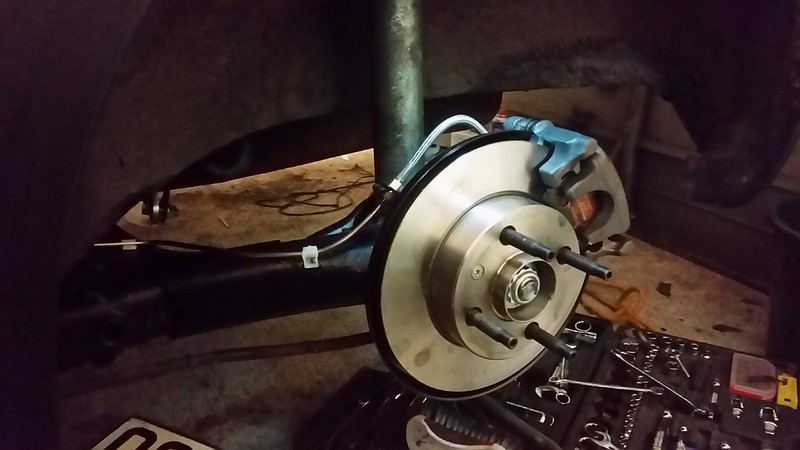

    well after some parts turned up i got the rear brakes finished up and bled

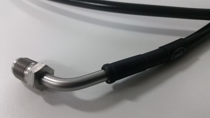

    I ordered up a braided clutch line to replace the OEM metal pipe one as i just wasnt keen on it
    The cars now back on 4 wheels, so i need to re-connect up the mid section and back box so i can fire it up again. getting closer to using it again!
    still need to think about what i am going to do about the under side and some of the rust i have found. I dont have the space to use a rotissary so i could strip the underseal while the car is on jacks stands which i dont really fancy... or i can completely strip it down to a rolling shell and send it off for that work to be carried out...and while its at it, have it resprayed.. but i think thats going to be big money right?

    i'm not really that happy with my own bay :cry: i want to put a polo or mk4 golf airbox in for the OEM look.. tuck the loom, move the battery to the boot etc etc etc etc.... the never ending list

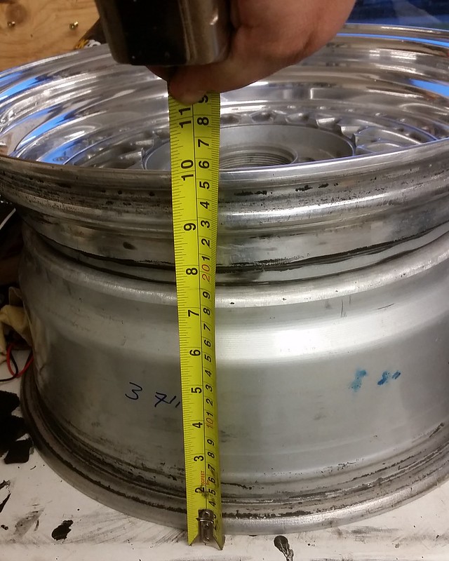

    picked up some 1.5 and 2.5" lips for the RS's about a week ago. i've wanted to go a bit wider on them for a while so i've shifted the 1" rear lips to the front from the 0.5" that were on before and put the 1.5" lips on the rear.
    i did try on the 2.5" lips which made things a bit interesting..but too wide for the car
    [​IMG]IMG_20180518_213229_367 by Cragmire40D, on Flickr
    rears now look like this and look much nicer
    [​IMG]IMG_20180527_224645_575 by Cragmire40D, on Flickr
