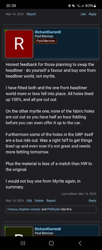

    Hello, please see below my thoughts on this screenshotted from the thread in member motors
