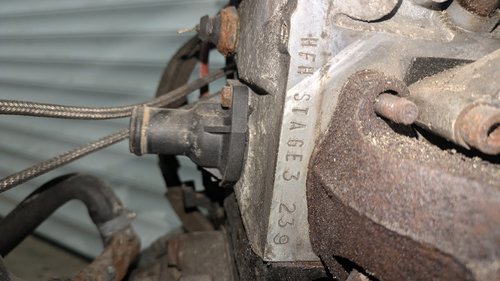

    Hi.
    Just bought an engine and trying to find some info on what head work has been done.
    Had this stamped on the side.
    Kris

    Spooky... was reading something on the 205GTIDrivers forum a couple of nights ago about an outfit called 'Hiflowheads', so Peugeot stuff, but might be the same outfit?

    hiflow heads used to advertise in the car mags CCC etc

    Yeah, found a few references and they did all sorts of stuff over the decades inc. VW 8v's (plus what the different stages involved), but the OP has gone quiet.
    They appear to have morphed into todays Raptor Sports (Kit) Cars, and still based at the same place in East Lothian.

    Hi. Thanks for the information.
    I am still looking for more on the company and what a stage 3 involves.
    Not had chance to get out and remove the head as yet.

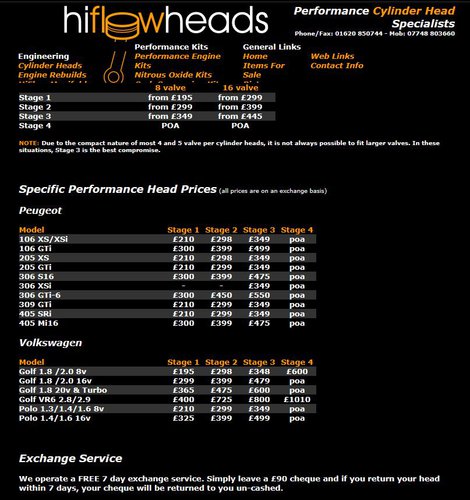

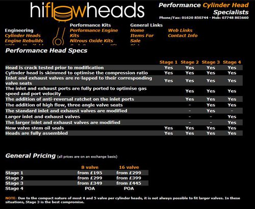

    Couple of site grabs from the end of 2004 - there's later ones going right up to 2018.
    If they have since become Raptor, their current day work mirrors the same options from back then - https://www.raptorsportscars.com/engines-rebuilds
    Phone call would maybe answer your questions.
