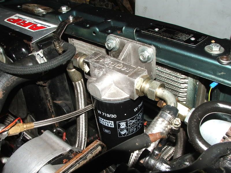

fit a twin Oil cooler set up (Standrad water cooled and a Mocal 12 row 12" fitted with sandwich plate adaptor) i had to fitt remote filter because of space on the MK1 but on a MK2 you won't.
