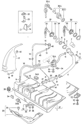

    Below is a copy of the 7zap schematic.
    I'm not finding much in the way of other useful images on-line to compare against.
    I understand there are dfferent tanks and that it's the K-Jet. / Diesel one I'm supposedly after.

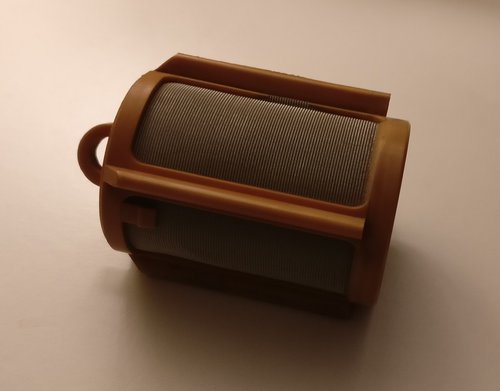

    Have read there is (or was) a swirl pot in these, partly borne out by there being a lidded plastic box affair in mine that the filter (28) sits in. Unfortunately I couldn't get you a good image, but I'd describe it as visiually akin to the one on MK2's, less all the pump gubbins.
    The yellowed filter pictured is seated in it.

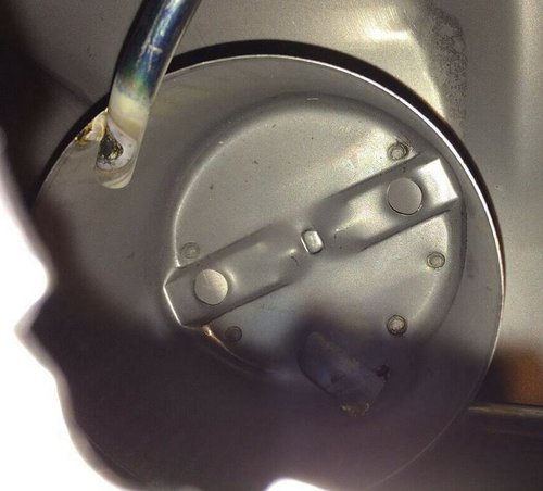

    This repro. tank is from a seller on eBay - I'm guessing it's a view of inside the tank through the fuel level float aperature?
    Hard to tell if that's a latter day alternative to a swirl pot, or it's instead just a cup for the filter and there is none.
    On those filters... There are replacements available (now blue if it matters) but any images I can find have 'For Diesel Only' molded on them. The mesh in the pics also seems to be much less fine a weave than the original - despite what the adverts say are they suitable?

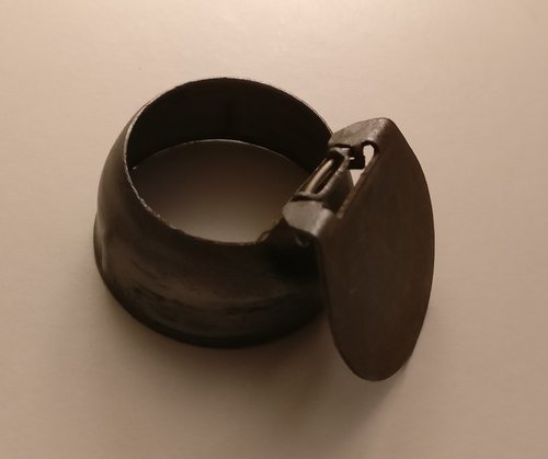

    I've salvaged everything from the old tank, including the flap at (27)... it seems to be a sort of non-return for fuel that enters the tank via the filler pipe. Do modern repro's have this or do you re-use the original?
    It's got it's own part number and was relatively easily removed.
    Also, the bracket at (1D)... is it on all tanks whether GTI or not, I may be missing it?

    thats a repro tank, the filter wont fit inside it. genuine tank have a plastic pot assembly inside which takes the filters, plus it has rubber seals which is the downfall of them as the rubber rots away and the pot stops working
    not sure on the filler neck non-return if it doesnt have one then I'd swap it over if it'll fit nicely

    some have said the more primitive aftermarket tank pot design can cause issues but I've no direct experience using one. without the internal filter yeah I guess more potential for crap getting in the inlet of your main pump. some make have a little mesh basket in the inlet of the pump also, when I tried to retrofit one to my bosch pump it wouldnt pickup any fuel so I had to take it out again (I had a genuine tank with in-tank filter)

    the cup thing is a swirl pot of sorts, just a more simple design but as you say no filter inside. a possible solution is extrnal swirl pot fed by pre-supply pump of some kind but if you have a standard GTI there isnt a lot of room under there thats the trouble. even if oyu found a good genuine tank chances are the rubber seals on the internal pot have gone which stops it working as effectively

    the original main pumps will definitely jam up if too much debris gets in, they are very fine tolerances inside which is why mk1/2 have mesh filters before the lift pump and main pumps. but as long as you keep your fuel system in tip top condition you'll be fine, main issue with the mk1 is fuel filler neck rusting allowing crap to get into the tank
