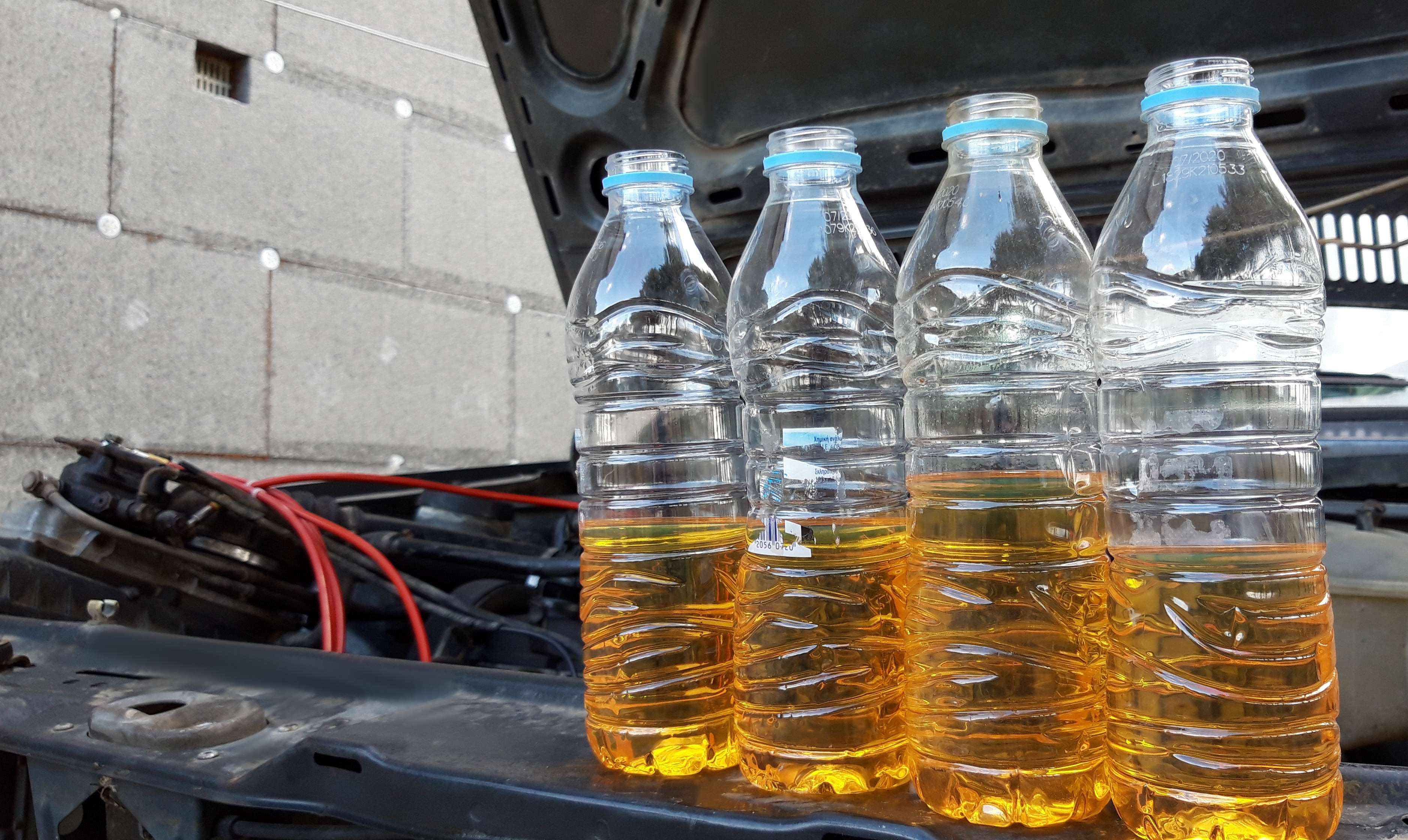

    I got the metering head near me dirt cheap, didn't really have any expectations from it but here is how it performed "out-of-the-box" when i tested it in my golf:
    Needs some very fine adjustments, but I can say i got lucky!
