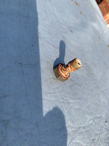

    Well, I have decided to try and minimise the affects of E10 in the vehicles I have 'lying around' . These
    are mostly tuned cars and bikes used for sport.
    So far, so good. An exercise of draining systems ethanol on carb fitting.jpg
    Get to the mk2 Golf Rally car and find the lift pump is u/s again.
    Its had two already, in the 3 years since I built it.
    Would love to run without it, but I need it to fill the under bonnet swirl pot, before being pumped onward at LP to the Webers.
    So, my question to you guys (experts) is where to buy a mk2 gti lift pump that wont fail after 2 hors running and 3 months standing?
    Also, I kind of expected some corrosion internally, but take a look at the piccy, this E5/E10 stuff is horrendous

    In summary;
    Banjo's into carb, corrosion,
    Inlet filters, 1/2 blocked with 'white stuff'
    Float bowls, looked clean, had 1/2 egg cup full of water in, when tipped upside down
    Obvious corrosion on closer inspection
    Pump jets, crap in
    Main venturi, Aux, OK
    Main float chamber, looked ok, but flooded with water and associated crap.
    Hidden, so more scary when tipped upside down
    Car ran 'ok', but obviously at major risk of running like a pig, very soon.
    Solution, no E anything
    Whatever it takes, avoid ethanol
    Jon

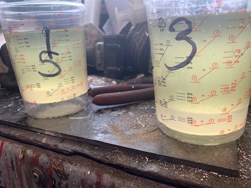

  10. Jon Olds Forum Junkie

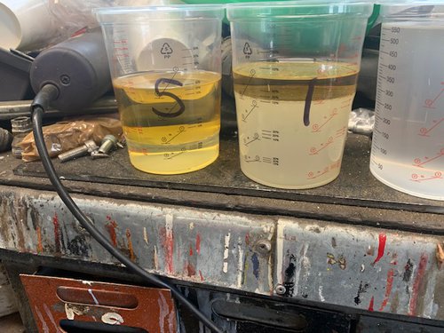

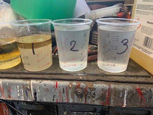

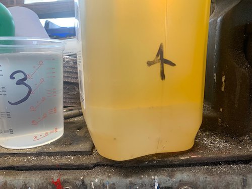

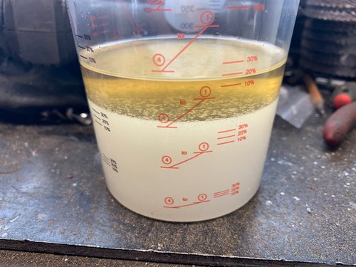

    So, here we are again.
    Same car, same problem.
    Hasnt moved since I flushed and rebuilt the carbs, drained the tank etc.
    Some great piccies though to illustrate the problem...
    petrol out of float bowls.jpg petrol out of float bowls.jpg petrol out of float bowls.jpg petrol float bowl then next two half litres.jpg petrol float bowl then next two half litres.jpg petrol out of float bowls.jpg petrol float bowl then next two half litres.jpg petrol out of float bowls.jpg petrol float bowl then next two half litres.jpg petrol left float bowl right 3rd half litre after.jpg petrol 3rd flush.jpg petrol 4th flush.jpg
  11. Jon Olds Forum Junkie
    So in summary;
    Car wouldn't start, except on easy start.
    So carbs syringed out, first piccy, 15% fuel, rest ???
    Next 2 half litres, pumped from tank 100% who knows what?? (no wonder it wouldn't run)
    Next 1/2 litre, a little fuel
    Next gallon, 60% fuel
    Question, where does 3 litres of crap come from when the tank only had 1.5 gallons of fresh Esso Supreme 99+ added
    when it was parked up.????
    I have 'no clue'. Surely condensation cannot be that bad? Is something growing in the tank? Have I bought a bad batch of fuel?
    LOL
    Jon

  13. dodgy
    You haven't got a sign that says "Gentlemen " above your petrol cap have you Jon?
  14. Jon Olds Forum Junkie
    I know, its the white liquid that is the problem though... Bought some Aspen 4 yesterday, maybe
    I'm going to be forced down that route.
    Also thinking that buying expensive V Power/99 stuff is a bit 'pot luck' as if its not shifting quickly enough at the garage
    goodness knows what's happening in those underground tanks....
    Jon
  15. Rustbuster
    Sep 20, 2020
    156
    May have a leak somewhere allowing water into the tank. Is your rubber seal on the fuel cap ok?
