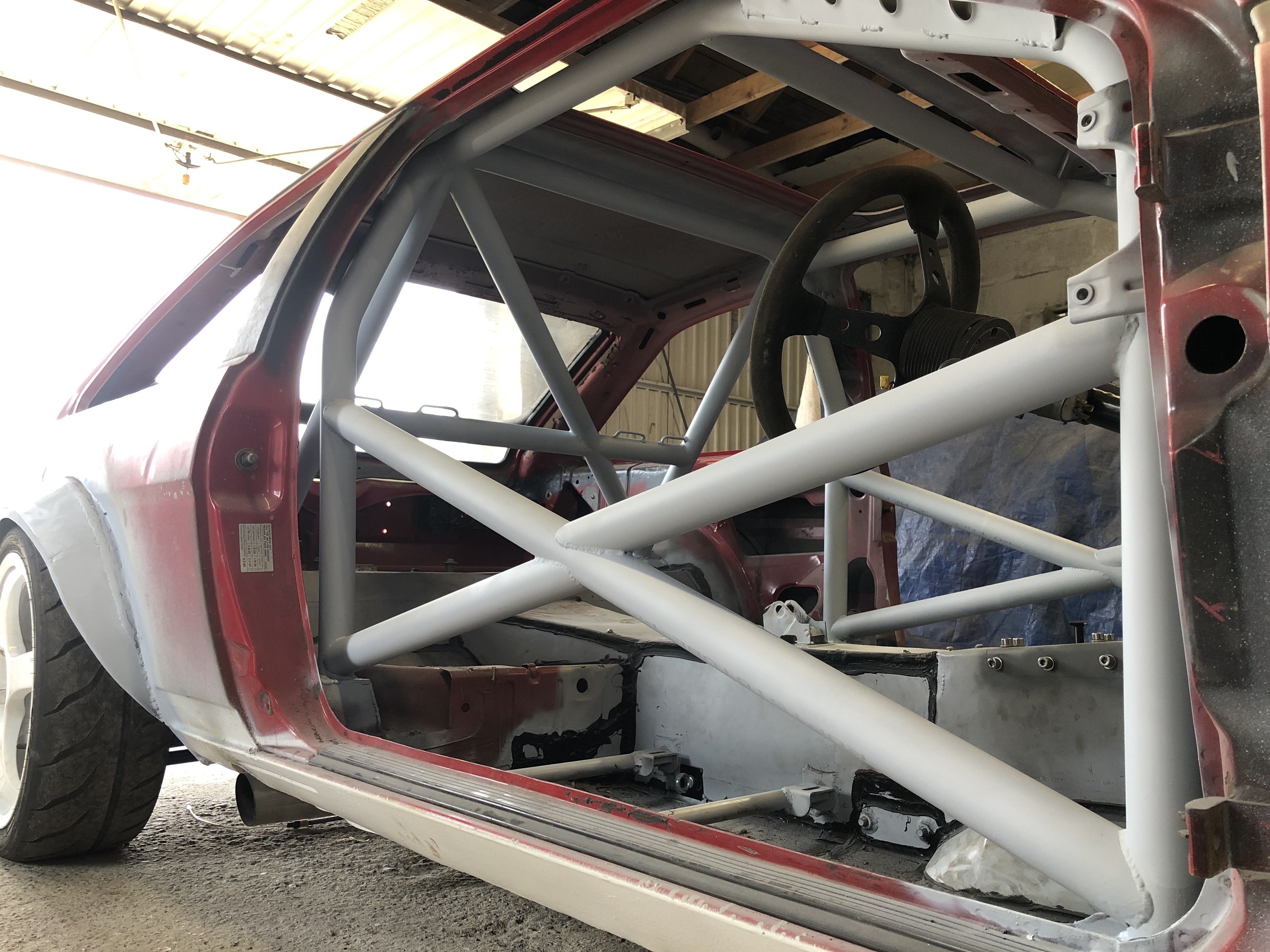

    cage cleaned up
    epoxy primed
    floorpans cleaned up, sanded down and painted in epoxy primer
    floors keyed up again and nailed in gravitex stonechip, will key up the rest of the interior now and then basecoat can go on, interior is going to be a c*nt to paint!

    Don't you want to weld those cross-fillers in the doorsides of the cage?
    I noticed the crosses are not exactly mirrored (sorry for noticing :p), they do make it more sturdy.
  3. Mk2daz
    Jun 2, 2015
    not quite sure which bits you mean?
