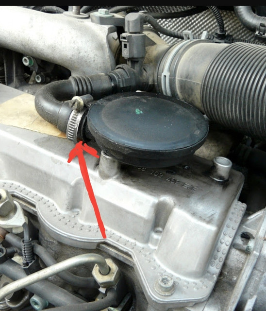

    Okay, thanks. I think I understand what I must check but just to be clear should unplug this hose and feel for air/vapour from this going to the left?
    free image hosting
    The image is from the web for reference.
  6. NateS2
    May 1, 2019
    260
    Yes thats right! and you should be able to feel air being sucked into the hose you removed
