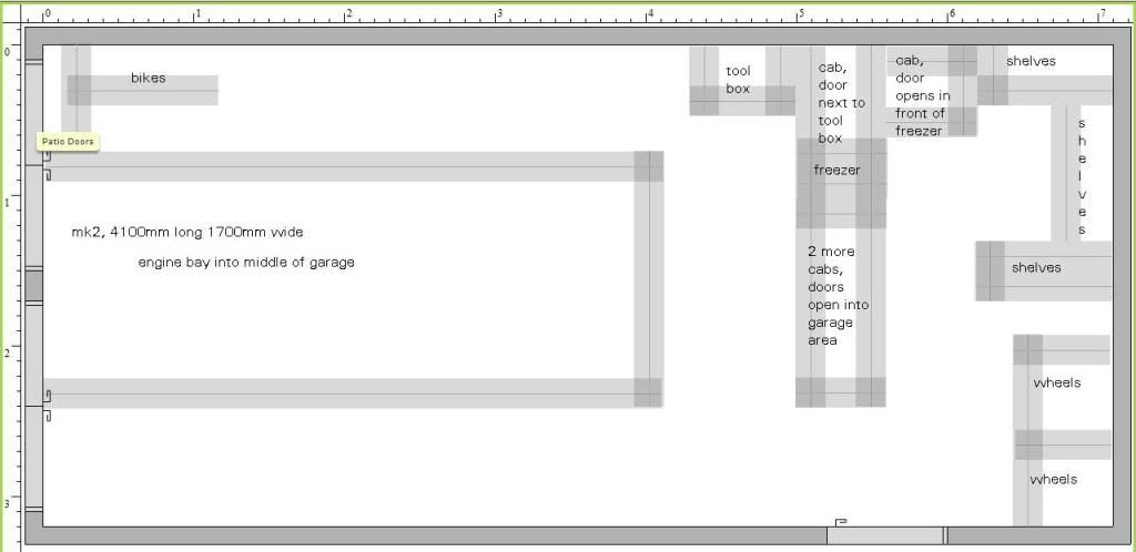

  17. M7R
    M7R CGTI Regional Host
    Oct 17, 2007
    Nottingham
    I picked up some 600mm kitchen base units last night from Discount Kitchens Limited, http://myworld.ebay.co.uk/discountkitchens2010/?_trksid=p4340.l2559 27.50 per unit with hinges, and they come with proper backs, not the normal floppy fibre board! went together OK, and bar a couple of bits where the edgring is lifting a little (which I have already stuck back down) they are spot on! and half the price of B&Q cheapo units (but you do get doors with them.. however im sure doors wont be 30!)
    So I have now started planning the final design, and I think what is shown bellow will be best... however it would be good to get others thoughts just encase I have made a big over sight.. all the drawings are to scale, the shelfs ate 400mm wide by 900mm long, the cabs are 600mm square fully covered by a work top, the tool box is 460mm x 700mm,
    design 1:
    Design 2:
    Im thinking design 1 would be best, as although 1 cab is covered by the tool box it is easily wheeled out of the way, and that one will only be used for stuff that I don't need all the time, like the spare turbo, gear linkage, and other random just encase spares.. This layout also means there is plenty of room to open the draws in the roll cab, and leaves the gang ways open.. the only thing im not 100% happy with is where the bikes are, as the original idea was to have them at the back of the garage, and the space round the car clear so I can work on it when ever I want etc
    what are folks thoughts?
  18. Ess Three Forum Member
    Oct 28, 2003
    84
    Aberdeenshire, UK.
    The lights look good.
    My suggestion with regard to the layout would be to not fix anything just yet...put the car in, use the freezer etc and see if it's workable before you firmly fix it all in place.
    For your wheels: Are you stacking them?
    Have you considered getting a local blacksmith/welder to knock you up an elevated wheel rack?
    Won't cost much...and you could store the bikes underneath.
    I'd keep the bikes well clear...I had mine in the garage near the cars for a while and was forever catching them and knocking them into the cars...at the rear, well out of the way, would be better.
    Good idea regarding the sockets up high - I fitted retractable extension cables / retractable air line in my garage to keep the walls/floor as clear as possible.
  19. M7R
    Oct 17, 2007
    Nottingham
    wheels are being stacked, as the walls dont give much option of bolting things on to. there are bolts holding each pannel together but they are only M8 and only used for holding small shelf units, so I think wheels off them would be pushing it, also there arent many bolts high up, so again the wheels would end up at chest height with maybe one more rack bellow, (wheel wheel racks could leave marks on the tyres depending how they are held as you will get pressure points. stacking spreads the weight better accross the tyre..
    The bikes down the side I agree is not idea, but there is narly 1m between the wall and the car, so there should be room, however like you said nothing will be bolted down, but the work tops will be cut and fitted, but if needs be I can always get another one cheap.
  20. Ess Three Forum Member
    Oct 28, 2003
    84
    Aberdeenshire, UK.
    Space is always at a premium...making best use vertically is always an option.
    What about some industrial racking along the back wall to allow you to stack the wheels & put toolboxes low down (on the floor) with the legs of the shelving giving you shelves up above?
    A set of wheels is only around 1m tall...toolboxes (Roll Cab without Top box similar) so that gives you a good metre of shelving/storage above, all along the back wall without taking up floor space.
    You could push the freezer against a side wall, and put cabinets down one wall if required.
    It would also give you the option to lean the bikes against the wheels, semi-tucked under the racking, to get them out of the way?
    Just a thought.
