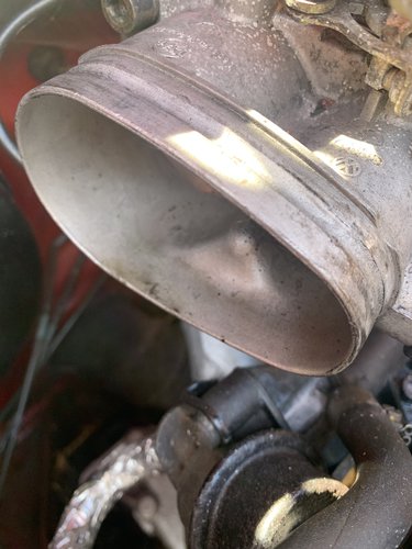

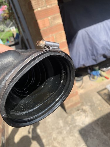

    Already replaced that.but did discover today
    When I removed large rubber intake pipe there was petrol in the throttle body and that rubber pipe.also smelt of petrol in the vac line from fuel pressure regulator.so I think this could be my problem fingers crossed.

    Petrol in these im sure isn’t helping.
