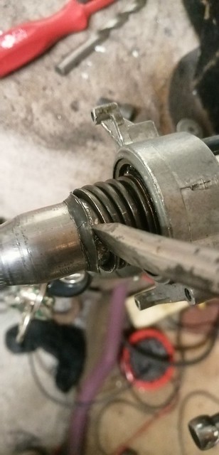

    Has anyone got a method of how to remove the lock washer at the top of the column so i can replace my ignition housing? I've tried chapping it off with a screwdriver but I'm damaging the column in the process.
    I've thought about just cutting it off and replacing it but there's no mention of it in ekta etc
    [​IMG]2022-06-27_08-32-43 by Paul Miller, on Flickr
  16. rubjonny
    just needs levering off, a 2/3 leg puller may help if its really stuck. try to lever it out on the inside where its cutting into the column shaft if that makes sense
  17. Rocco_Balboa Paid Member Paid Member
    Aug 30, 2017
    Glasgow
    I managed to find the part number suitable for a mk2 golf and ordered a new one, I can now remove it without worrying about destroying it during removal.
    The steering column in the Haynes manual looked nothing like mine so was next to no help
