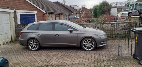

    Had the main car off the road since before Christmas, broke a front spring in a pothole incident, obviously the road fund licence of all these electric vehicles is being spent on road maintenance, haha.
    Anyway, decided was time to replace fully as just over 100k on it and quite a heavy beast. So after talking to DPM performance a set of koni shocks along with eibach springs were ordered.
    Shocks arrived next day, springs due day after and had notification from courier saying so.
    2 weeks later they arrived, thanks dpd!
    Garage fitted the rear setup, and went to fit the fronts, but both bolts sheared in the hubs so play stopped as couldn't get them out, 2 new hubs ordered they are same as S3 and golf R on my car and alloy not iron.
    Delays again with delivery from abroad, then 2 weeks in this country due last Wednesday, car went to garage to have them fitted, plus new toyo sports all round, new pads and other associated suspension bits plus a fresh mot..... well up until when on Thursday got a call saying DPD have lost the pair of new hubs!
    Had a discussion about the next step, and managed to sort a solution.
    Picked it up yesterday, and taken it on today's trip, nearly 300 miles.
    Suspension has settled nicely, much nicer handling now its all fresh and not soggy on back end, hopefully the pads will be less dusty than what was in there too.
    Last year had new cambelt with service, and still happy with the dpf 'solution ' and remap from couple years ago, possibly considering a different set of wheels but seriously thinking of Porsche macan calipers and 345mm disc upgrade, if anyone has done it on an mqb car I'd be interested to hear their thoughts on it.
    Nice to be back in it, despite all the delays I'm glad I went for the full suspension kit.

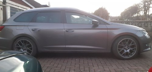

    Just collected the car after having the tracking rechecked following the suspension settling, and a nice set of BBS alloys swapped.
