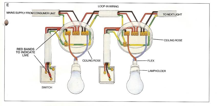

am running the wires for the lighting in my garage (an electrician will be connecting them up, but i need to run then to the lights first), and have a couple of q's... does the wire coming out of the fuse box need to go to the switch, or to the light (and then another wire from there to the switch)? is it ok to use 2.5mm squared cable?

ok...the wiring from the house to the garage is already there, i had lighting in the garage already but the wirign in the garage was a joke. so am re-wiring whole lot. just i took the approach of ripping it all down and then starting again....so not sure whether the wire come out fuse box and goes to lamp, or to switch?...previously it when into what looked like WW2 junction boxes!
Hope this helps and use 1.5mm2, the colours of wires need to be in accordance with new BS standard - the actual colours will depend on what their are currently and what their is in the consumer unit.

damn it...that means i have to run a fair few more wires. is there no way to send the power supply directly to the switch? i have two lamps running off one switch, so gonna be lots of cables everywhere good idea prof, but isn't really necessary as the large doors bolt up from inside only, and i prefer the lights off when reversing in at night.

i ran cable from board in garage to one side of the switch and then fed another 3 core cable to the first light and then 3 core from there to the 2nd light.
consumer unit to light - 1 cable. light to switch 1 cable light to light 1 cable 3 cables - a few cable clips, hammer and a cup of coffee job done.
oh i think i'm getting it now (i never thought i'd find it so hard to get my head around garage lighting...still, good to learn new stuff) i don't need to run a wire from switch to both lights, just to the first light? right?
yep you've got it on the diagram i posted, this is for a two room scenerio or if you wanted two seperate lights and switches in a garage - maybe the lighting outside and inside so you could switch independently. What you need to do is: the second light will take its connections from the ceiling rose of the first at the connector block with the red cable that comes down to the bulb as well as the connector that has the blue cable coming down to the bulb and finally the earth. I will try and draw it on a paintbox file and attach - give me a while though.
