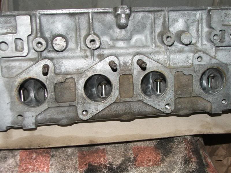

    I have a 1996 Mk3 16v ABF.

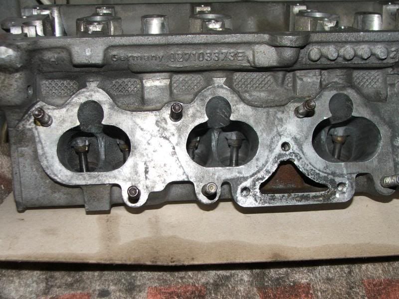

    I have recently acquired a polished and ported head part number 027 103 373E which I believe is from a kr engine up to 1988.
    Will this fit on my abf block without modifications?
    I plan to run it with standard abf cams for the moment.

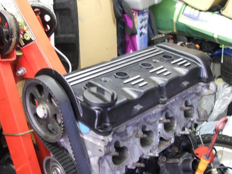

    The ABF Cam cover won't fit u will need KR rocker cover gaskets too and timing belt tensioner.

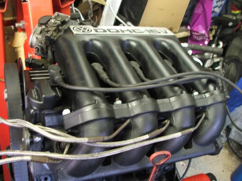

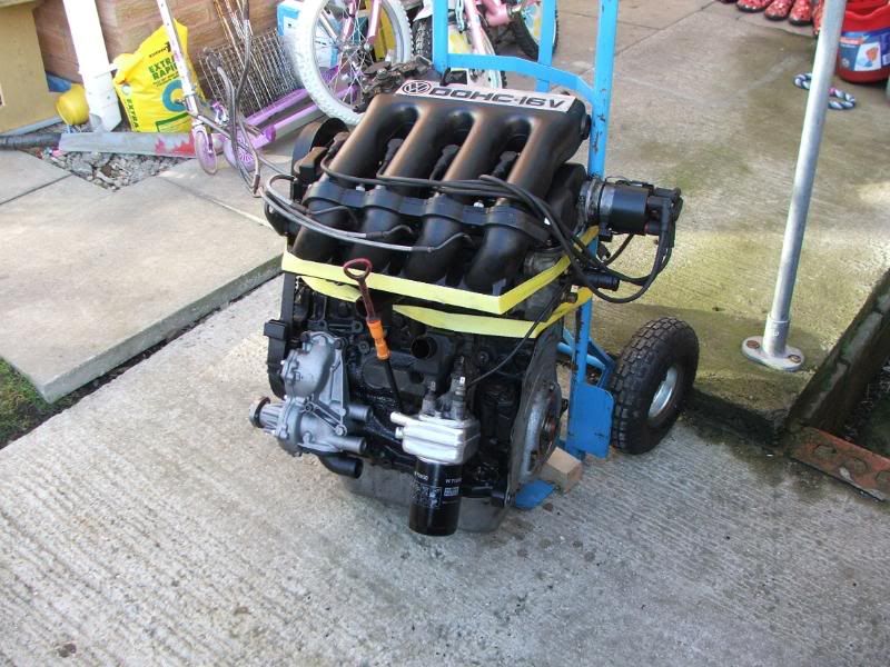

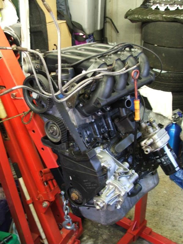

    Heres a 2.0L 16V Engine which i built for CrazyNick from MK1 Owners forum for his White MK1 Project, to fund my 2.1L 16V Project.
    Heres the 2.0L ABF. :)
    I'll post pix on the 2.1L 16V Engine Build.
    [:D]
    2.0L 16V ABF Bottom End
    KR 027 16V Gasflowed & Ported Head
    ABF Cams fitted.
    50mm Inlet Manifold
    should be good for 175BHP.

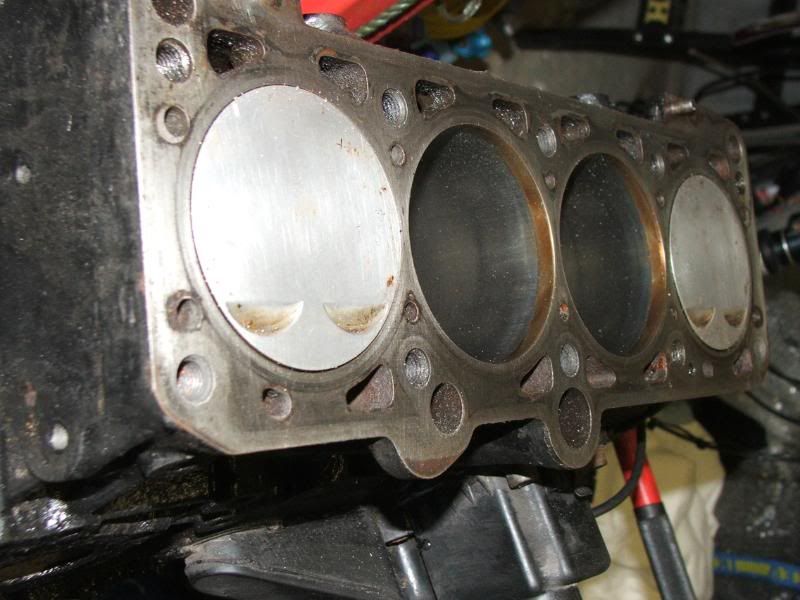

    Shave down the dowels on the back of the block by about 3-5mm, because if the head's been skimmed heavily, it might foul on the dowels and not seal properly. Block all the holes in the block to make sure you don't get metal filings in it, obviously.
