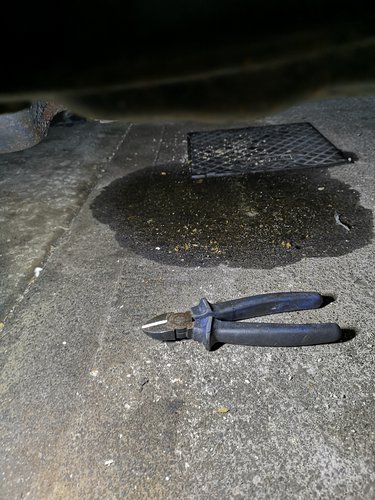

    The photo below is gearbox oil that was left under my car after leaving it running for 10 minutes outside and then pulling it into the garage. I'm not sure if it is being released under pressure or pooling somewhere and then dripping down.
    There is no oil entering the cabin via the speedo cable but that doesn't rule out that oil is collecting on the cable and then dripping out after the car has stopped.

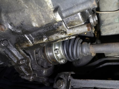

    Dry around the output shafts?
  3. davkav
    Sep 30, 2010
    141
    Ireland
    Yeah all dry around the shafts. I'm heading out now to open the fill plug and see what happens.

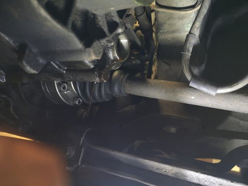

    Speedo cable doesnt look too bad, certainly not wet enough for the amount fluid seen on the ground.
    Passenger side view
    And fill plug removed. A little bit of fluid ran out but nothing major

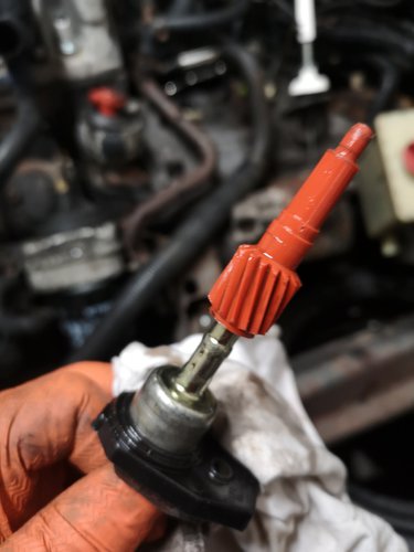

    And the speedo cable removed. Can anyone tell me if the O-ring #10A in this graphic is missing from my speedo type cable, or is it for another type?

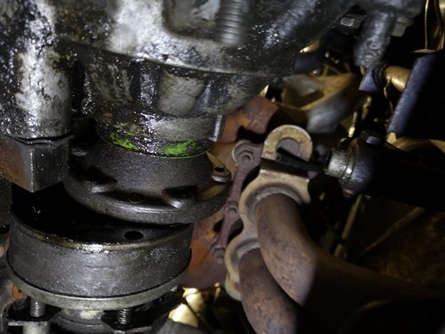

    Any sign of oil around the green cap on the side around the 5th gear housing?
    I had an 020 that was leaking. It was coming from the output shaft seals and the green cap that I mention above.
    It could also just be the main casing gasket needs replaced!
  6. davkav
    Sep 30, 2010
    141
    Ireland
    Good point, I forgot to mention that. Green cap is bone dry also.

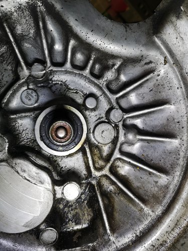

    So I got the gearbox out. On closer inspection it looked like the oil was coming from the driver side of the box
    And sure enough the culprit is the input shaft seal is leaking. The gearbox oil must be collectin the bell housing and then dripping out when the car is stationary
    New seal will be ordered and that should sort it. Ill give the box a good scrub too whilst it is out of the car.
