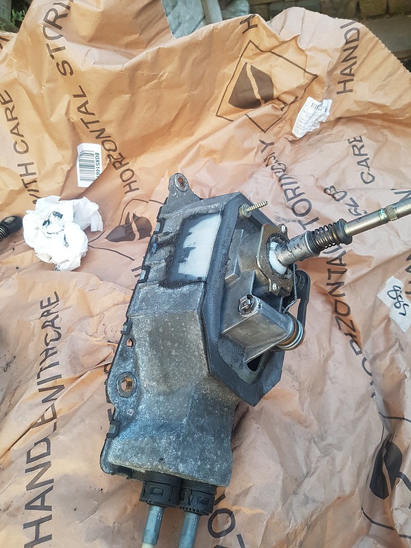

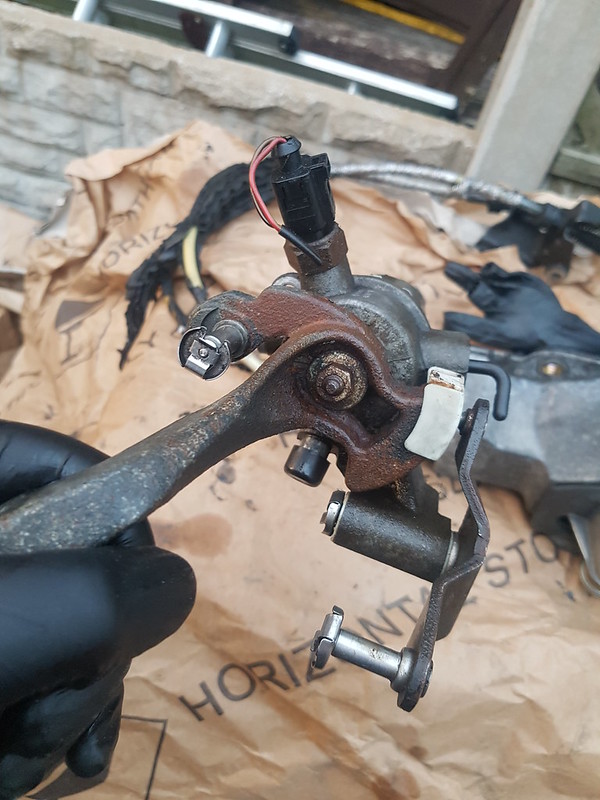

    After doing some reading and realising the benefits of an 02j tower setup, i got a little carried away and jumped on the first cheap 02j tower/shifter i saw thinking that all the 02j stuff was the same. Unfortunately i did this before i had read enough to realise there was an old/newer version of the tower and different shifter housing/cable types. I "think" i have the later tower, but would you guys please confirm for me? The tower part no is 02j 301 232 B
    Secondly the shifter i picked up isnt a mk4 gti item, but im lead to believe is a closer fit for a mk2.(looks to be the same as the item in THIS THREAD) Should the cables still fit? Or do i still specifically need the mk4 cables?

    I can't seem to find that part number in ETKA at all. Looking at the pictures it looks exactly like the version i used from a 2000 MK4 GTI. That is the later tower as it has the better style pin connections for the cables rather than the ball joint type.
    Not sure about the actual shifter sorry although again it looks just like the MK4 version i used. Pretty much identical. Can you get a part number from the casing?

    all looks okay....pin style tower and the cupra gearstick is the best one
    id suggest a strip down on that tower...under that nut is a roller bearing thats probably rusted to hell , worth swaping that and any other worn bits

    'early' 02J gearboxes effectively had 02A type shift towers and your's is definatly a 'late' 02J

    Yea from what id already read it seems that the bearing is susceptible to corrosion and was definitely on the to do list. I forgot to mention that the tower didnt come with the cup that bolts into the gearbox casing at the opposite end of the shaft - is this required too?

    can only suggest you measure the shaft on the old part and see if matches the new one , i had to swap mine on a 91 gearbox

    Only if your existing shift tower has the smaller diameter shaft/bush and the only real way to know is by removing it.
    That said, it might be worth buying a new one as your existing bush is probably worn (ooh er missus)
