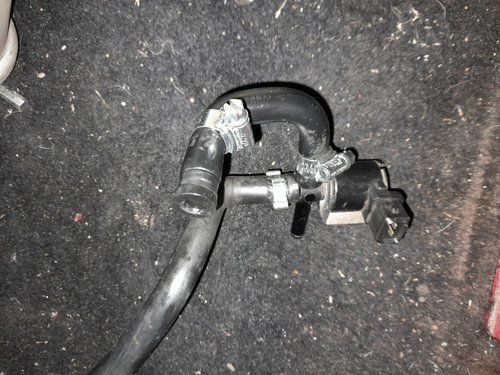

    We have just fired up a rebuilt engine and got clouds of white smoke from the exhaust on a mk2 Golf conversion.
    The engine has bang on compression and no oil on the plugs or around the exhaust manifold on the head side.

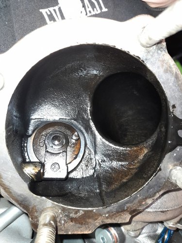

    The turbo however is soaked in oil on the turbine side and slight oil on the compressor side.
    We are assuming the seals have blown in the turbo.
    We disconnected a lot of pipework so could we have caused this failure?

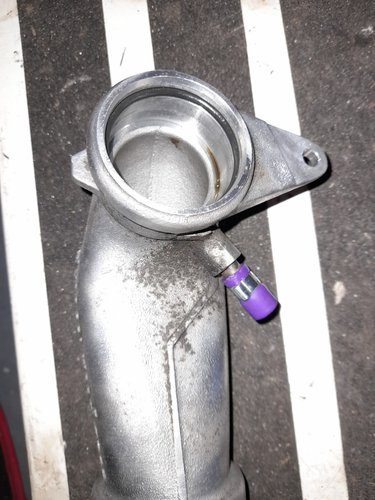

    The pics hopefully show what pipes we left in place as well as connecting the forge valve to the inlet.
    The turbo was a remanufactured KO3s but the supplier no longer exists on Ebay and their website phone number rings out and their facebook number says incorrect number so not looking promlsing.

    Only way oil could leak if turbo is good, is from a blocked oil drain. Otherwise turbo seals are bad.

    I think we caused it as we ran a pipe from the crankcase straight to the rocker cover for start up and inadvertently created a blow by problem which caused crankcase pressure and thus prevented the oil draining back from the turbo so it went the only place it could, down the exhaust.
