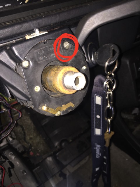

    REALLY WEIRD, if i adjust these screws and crank it it sometimes starts.

  11. Finite
    Nov 20, 2004
    255
    Northamptonshire
    Is anything else intermittent on the electrics? The ignition switch could be on its way out.
