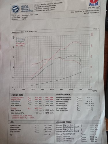

  7. Matas Forum Member
    Nov 2, 2019
    Here are results after dyno
  8. Toyotec
    Looks typical for the plots, although at a 7000+ rpm limit, do you have a chip fitted?
  9. Matas Forum Member
    Nov 2, 2019
    What do you mean by saying looks typical for the plots? And i have no idea, i havent touched computer since i bought the car, i changed some parts that should have helped and checked for fault codes many times
