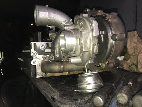

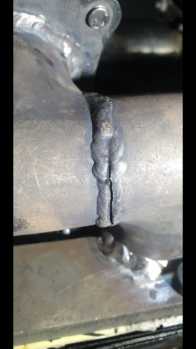

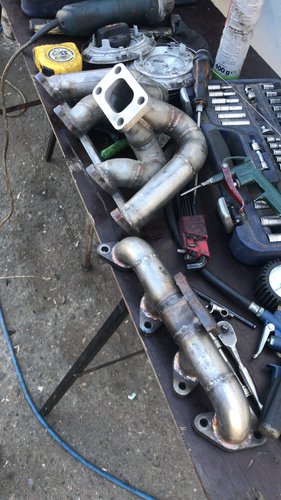

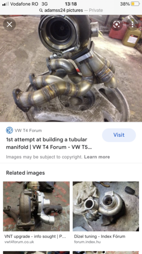

    not trying to pee over your bonfire but those welds on the collector manifold are awful. You should check your settings on your tig machine, either youre welding too hot or your shielding gas is escaping. What filler wire you're using ?
  12. Adamss24 Forum Member
    Jun 21, 2021
    50

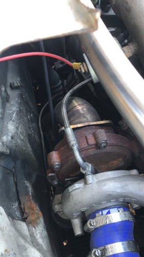

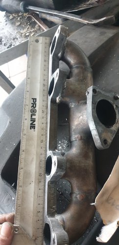

    It’s not a bad effort but these types of tubular manifolds are notorious and crack at the collector end ! Make a strong support for the turbo as it looks heavy and allow for expansion as it’s a large engine and it will make some heat running on full chat. When you weld the manifold runners take them both one by one and purge them with argon gas…if you welding hot then move a bit quicker…make sure you’re not using disposable gas bottles and you keep the flow rate high if you’re welding outside ! N C27CF6A4-33C6-4842-8DE0-4A26DB45DB00.jpeg 747992AE-3B35-4819-9B5D-ABF8C6E7148E.png 2A6C004D-CEF2-4FBB-9B2D-59B95AEC079C.jpeg A91D73A1-3E42-468E-844E-D50E76EDF816.jpeg Not a bad effort but there is room for improvement!
    erreesse likes this.
  13. Adamss24 Forum Member
    Jun 21, 2021
    50
    Get a decent size bottle of argon from the likes of Adam Gas, Barnet welding supplies or BOC if you like to pay subscription! As I said, I weld all sorts of stuff all day long, it’s just constructive criticism! Practice makes perfect ! If you look at the above manifold it warped over 1cm at the flange and that was on a lousy 1.9 pd tdi ! It pulled the studs out of the cyl head ! Since fixing it it’s going ok, no more leaks ! Keep up the good work mate !

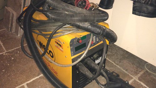

    There are really good deals out there now if you think of getting a tig, jas8ic, Paton and r-tech are the entry level good quality welders at under a grand, you can get DC only machines for 1/2 that amount ! If you’re feeling flash then Kemppi, GYS, esab and EWM all do decent welders but price doubles…I used to weld with a thermal arc ta202 AC/DC, now it’s only marketed and sold as esab- brilliant piece of kit (parweld is built on same circuitry but less features)…2nd hand market is also flooded with ex demo/shop soiled/refurbished welders from r-tech, they use a timeless design on their Analog welders( one of my mates is using 2 and he is a professional welding outfit and they don’t get turned off during the day) and the digital ones are even better ! For some jobs mig is a lot better, especially if it goes to low amps as well for thin gauge/rusty metal !
