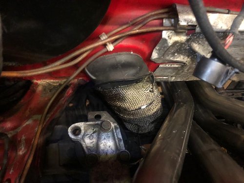

    I wrapped the boot on mine with exhaust wrap (can't afford ceramic coating, and don't like the idea of wrapping the header). Lazy mans option but hasn't melted anything yet :lol:

    I'am not a real fan of exhaust wrap as it can cause cracking due to heat buildup,mild steel is generally ok but stainless is more prone,seen this first hand,best to wrap the section of pipe near the rack boot (as shown ) and you will be golden.

    I wrapped my boot in that gold stuff before, worked a treat, this time I’ll make up a nice little aluminium shield as I’ve got loads of space
  9. Tristan
    Heat shielding works best if there's an air gap between the item you are protecting and the material you are using to reflect or deflect the heat. So gold foil on a bit of ally plate, even if it's only a few mm away from the boot would be better than just wrapping the boot.
