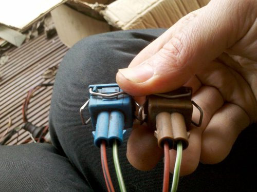

  6. Tiago Sainhas New Member
    Apr 9, 2020
    Hello rubjonny, thanks for your help,
    the thermoswitch are working fine, the green/white on brown plug has direct with green of blue plug, with temperature 15ºc (cold) the pin on thermoswitch have earth (0.3ohms), the other just receive 12v when cracking and cut the earth of another pin because the motor doesn't start, but the problem is the 5th injector when on cracking are continuously injecting fuel, and just when the thermoswitch cut the earth its was when the engine run... if i unplug the 5th injector the motor run instantly...
    do you know the temperature at the thermoswitch cut the earth?
    or do you know the reference of this thermoswitch?
    best regards.
