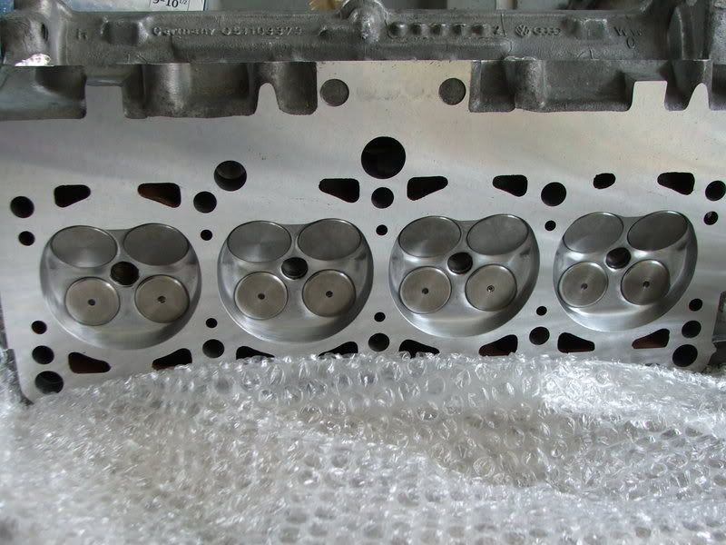

  9. Admin Guest
    Is this head on the pic from KR???

    What is the part number on your 9A cylinder head?
