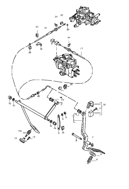

    Quite a few areas to look at: 19 - 20 - all the pivots and adjuster

    Being a bear of very little brain, I'd really appreciate if anyone could post a photo of the bit where I should be squirting stuff, as last time I tried to fix something, I broke it! [:$]
