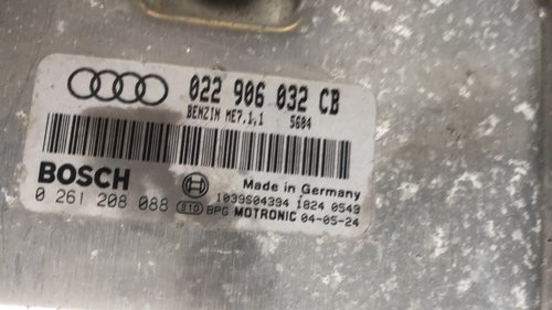

    The ecu with the BDB 022 906 023 CA

    Interesting what ecu part number have you got?

  11. Toyotec
    There is a lot of conflicting information from lay folk who never studied why that is so.
    Your ECU is a ME7.1.1 CAN and only accepts a digital signal. Hence the reason you use a MQB pedal as it hangs like the original MK2 pedal.
    DJP likes this.
