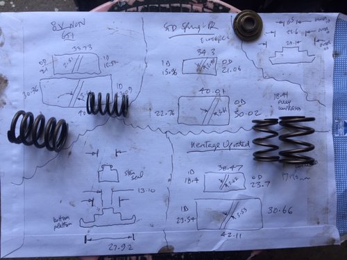

    I am at the stage of rebuilding my aftermarket autotech big valve cast head ready for a race engine build. Some issues have arisen as I have measured the above springs, compared them to the std spings and checked compatibility to upper retainer and lower platform.
    Measurements attached.
    Issues;
    1. Outer OD is tight into lower retainer, meaning there is a chance it will not fit 100% square.
    2. Inner spring OD touches the outer spring, meaning potential friction in use
    3. Inner spring ID is a very sloppy fit on the upper retainer
    4. Outer spring ID is a little sloppy on the upper retainer
    5. Inner spring ID is a sloppy fit on the lower retainer
    All of the above leads me to think these springs aren't designed to fit the stock retainers.
    What is the clubgti opinion? ie anybody used these? Upper valve spring failure in use will always wreck an engine, so I always measure up.......
    I could make some custom lower retainers, no issues, but the uppers?
    Also, inner and outer touching in operation cant be a good idea, can it?
    I will ask VWH tomorrow for their opinion. One option is using the uprated out spring only with a std inner, but at the moment I am inclined to return the whole lot to VWH for a refund 8v uprated valve springs.JPG

    So the outcome of all is is quite interesting.
    Obviously, the dimensions tell you they don't fit , or are not 'designed for' (IMHO) the retainers.
    The US suppliers say the dimensions are correct and 'they'll be alright'.
    Me?
    I don't think so.
    They are being shipped back tomorrow.
    All this has wasted 3 weeks in the build.
    So I now need some aftermarket valve springs to suit std retainers
    Anybody any recommendations? Before I buy a full kit including top caps..

    I've fitted a few of these lately and they've all gone in fine. I bought mine direct from the USA when I was over there. They won't go in a crossflow head as the setup is different but the ones I've had have dropped straight into both 8v and 16v heads.
    They are snug in the lower spring seat which I don't mind, but the cap fits fine.
