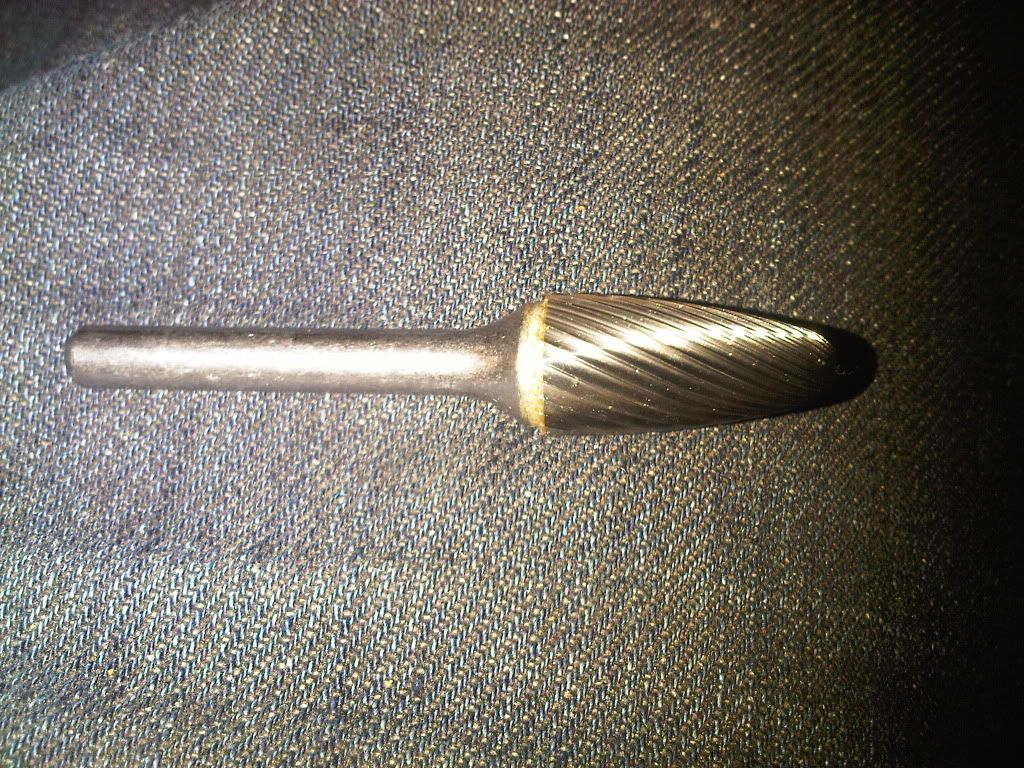

    Ive got a tree shaped burr infront of my and am waiting for a ball end (i said ball) one in the post. A friend has a dye grinder i can use so all i need to know now is where to cut out what.

    Ah good. A tree wont be much use, you'll need an oval and a straight with a rounded end..but the ball will be handy...depends what work you want to do.
    Get it back first and we can take a look from there.

    This is the one ive got
    According to the roebuck site its an oval, but the people in the tool shop said its a tree.
    Can you clarify?

    Have you ever seen a tree that shape? !
    That's not the proper oval but its ok..
    I'll dig out the part numbers I have.
