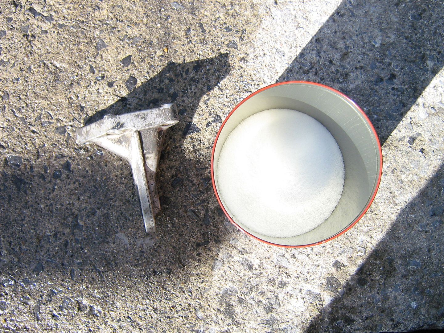

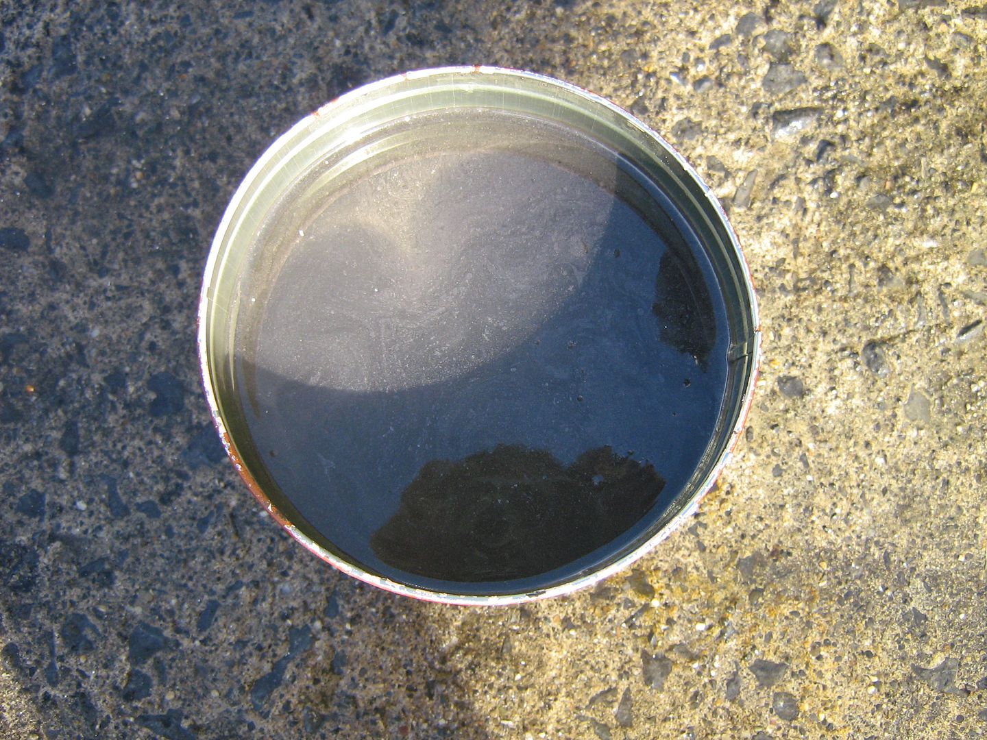

    The tin pictured here is about 1.5litres. I added to that around a half inch of caustic soda.

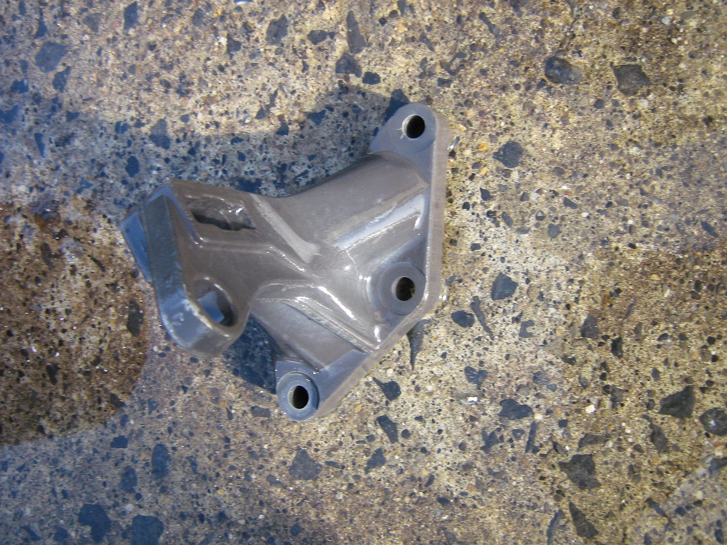

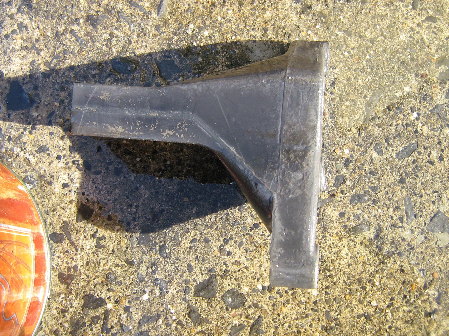

    The gearbox bracket on the left is fairly dirty and grubby as you can see,

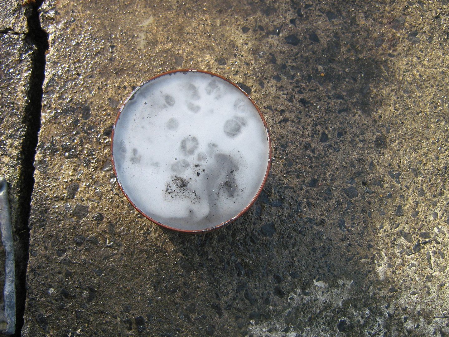

    Add the caustic soda to the water stirring all the time, it will get hot but wont boil, leave your part in slowly, it will fizz like hell and give of hydrogen which is flammable so do it outside,
    Give it around 20min in there or until its all dark grey/black, lift out and rinse off well with water, use gloves...

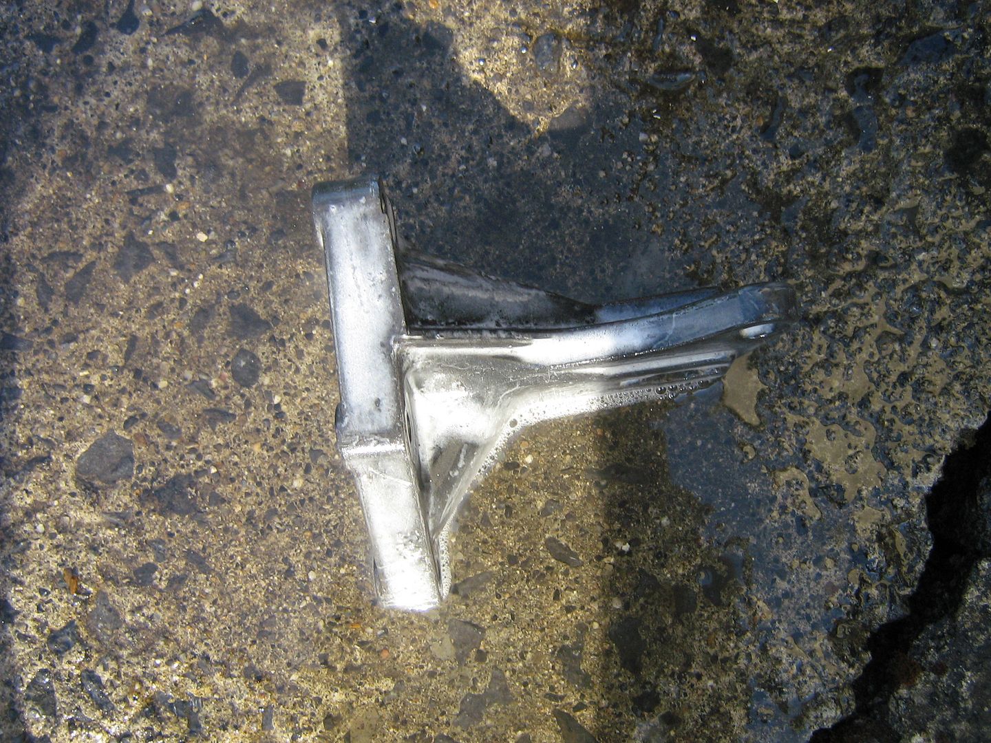

    Rinsed, lots of smut present on part,

    The reaction is minimal here this time as Nitric wont oxidise Aluminium, only the other components in it = smut on surface.
    15min is all it needs,
    And out, still looks dirty but this rinses off easy as the smut has now been removed chemically from surface and is just sitting there,

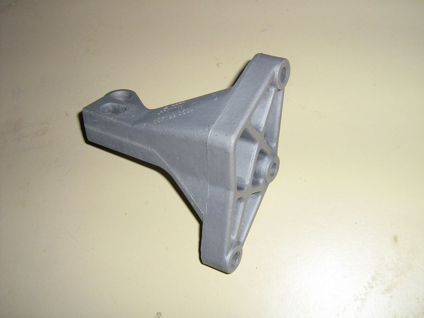

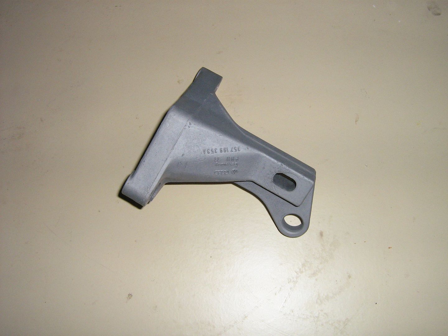

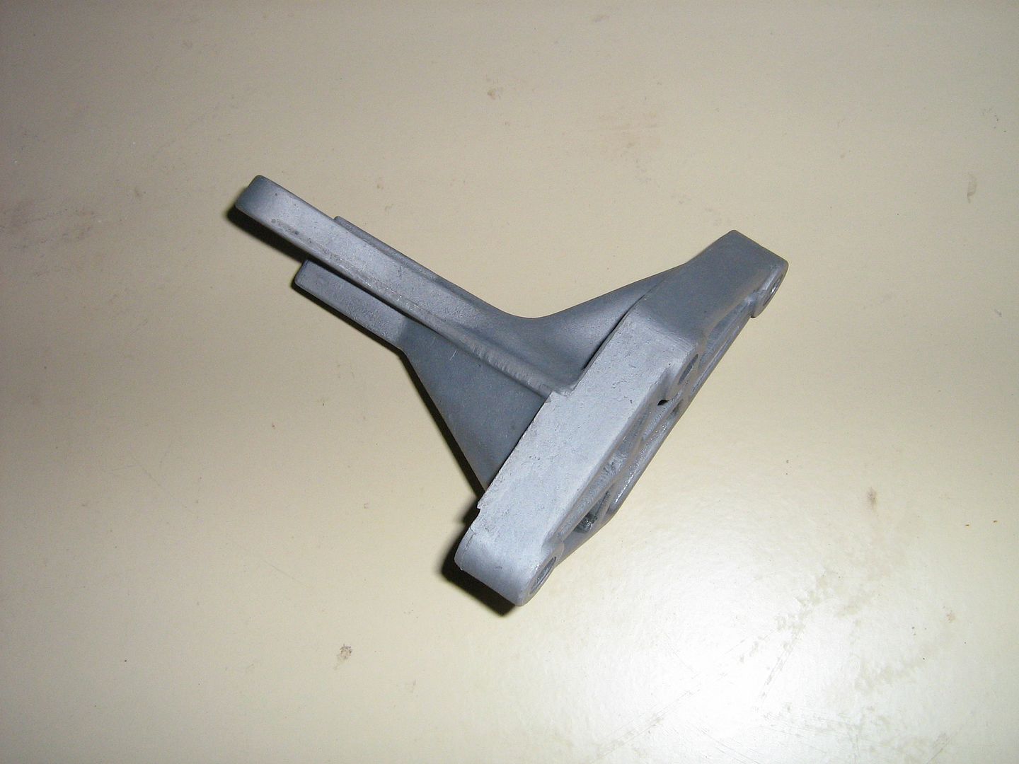

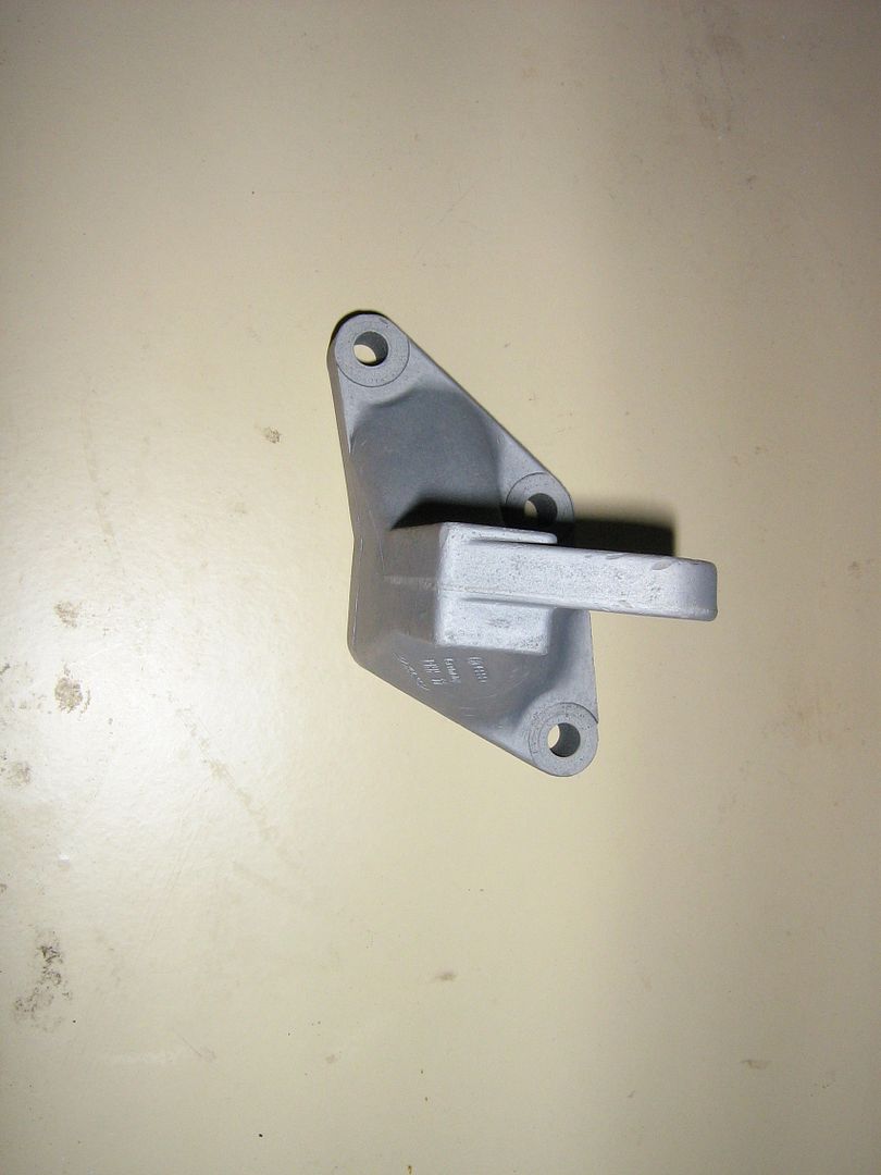

    Once rinsed it will look like this>
    Not bad hey?
