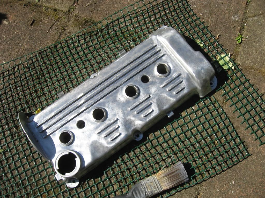

    I found my rocker cover yesterday, so was inspired by this thread to stick mine through the dishwasher. My wife took it quite well. :lol:
    Before:
    After:
    An improvement, but more work needed.

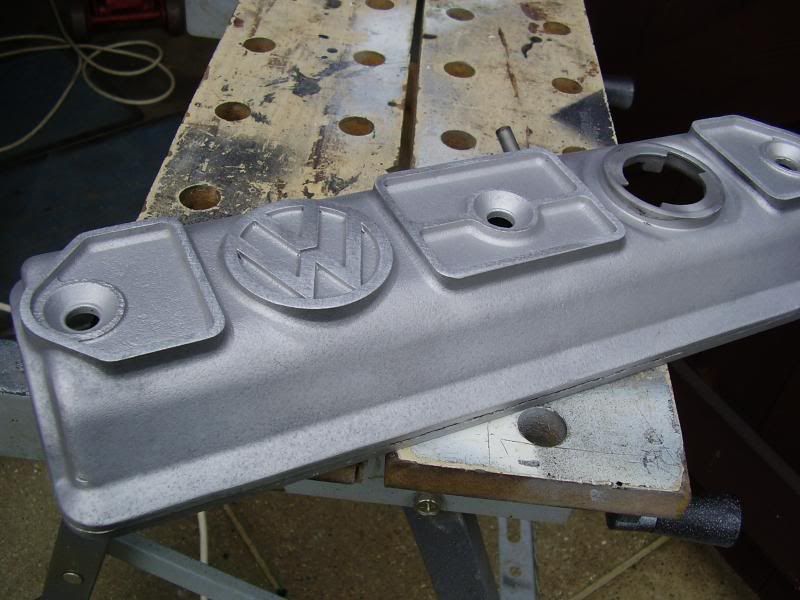

    heres a glass beaded one...just some wd40 and a scotch pad to maintain it once in a while, no worries about it chipping or peeling ,job done!
    before
    after

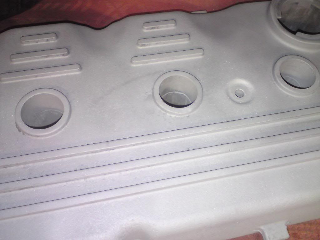

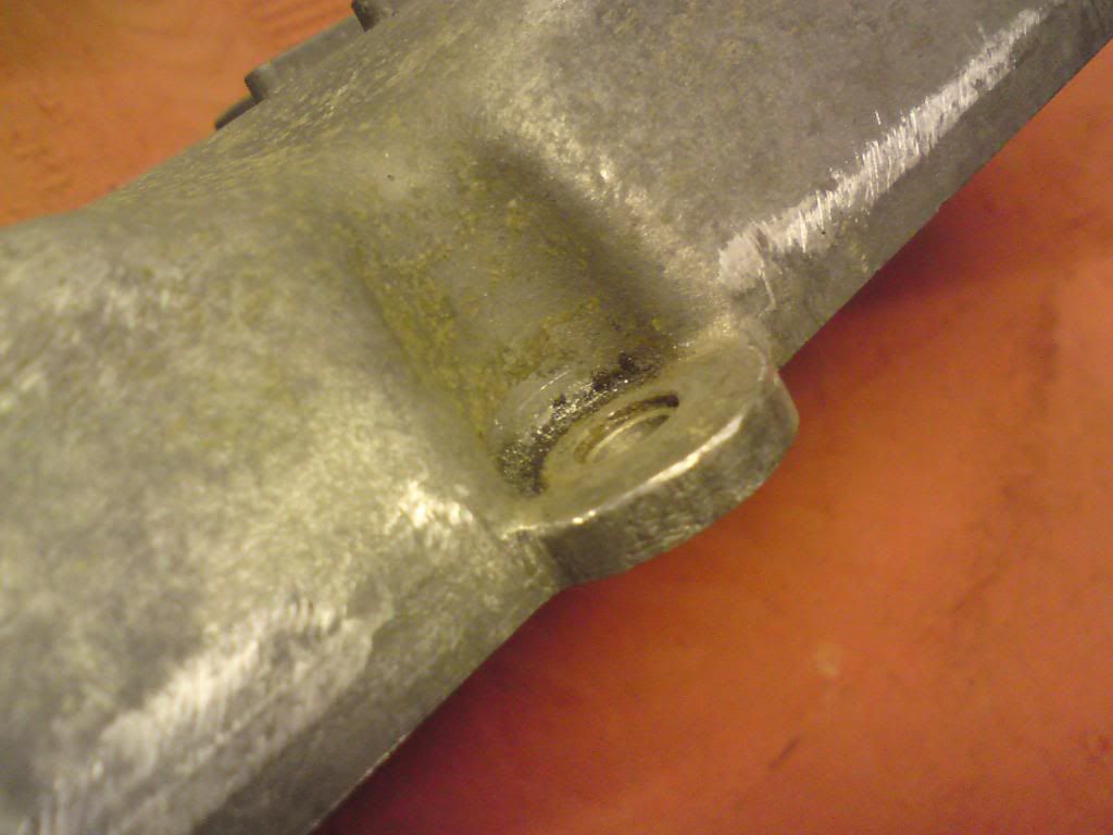

  6. barny Forum Member
    Lost in Glos

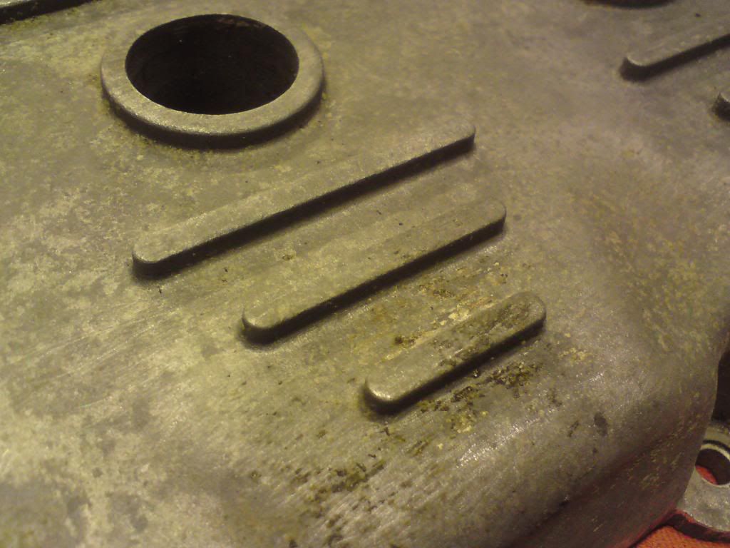

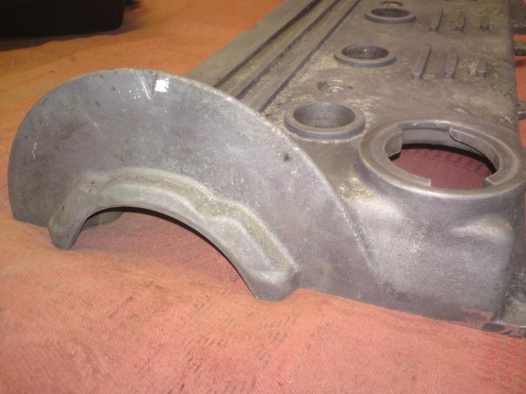

    A few update pics for you Chris;-

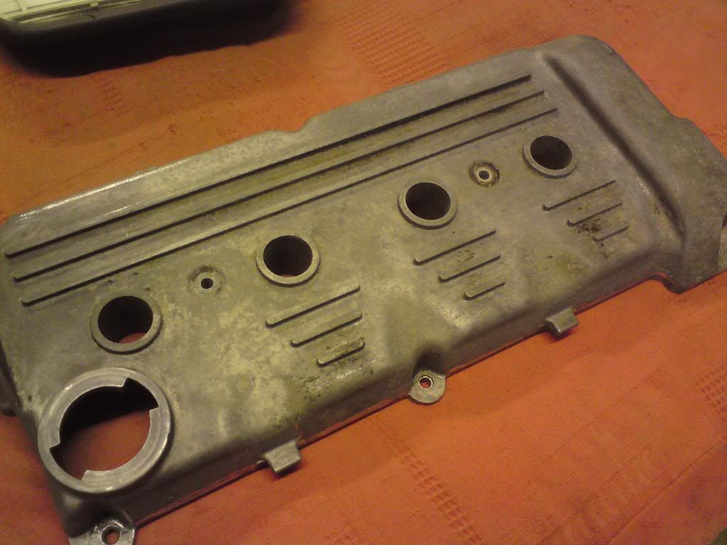

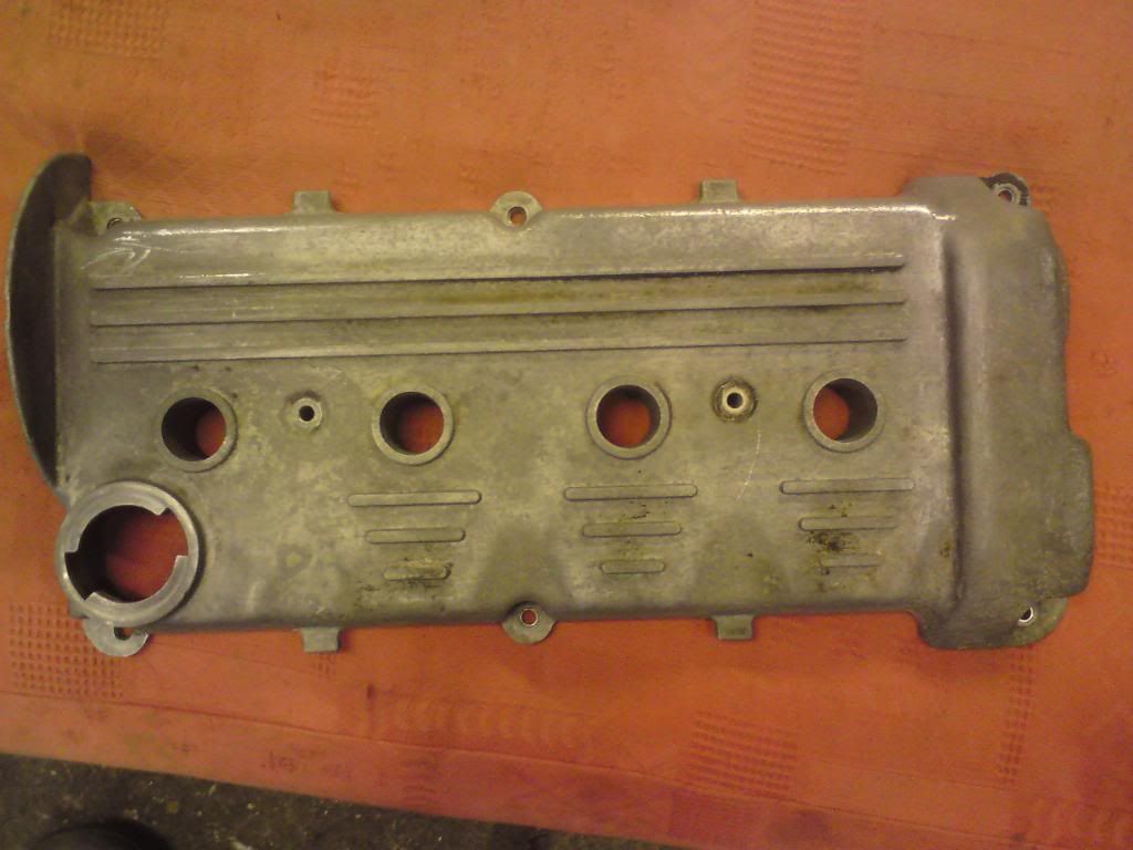

    As delivered
    Obvioulsy clean! But cack baked on

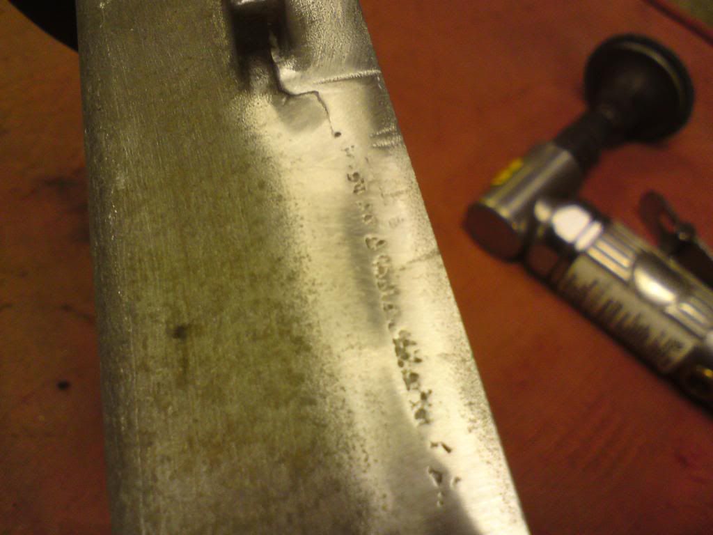

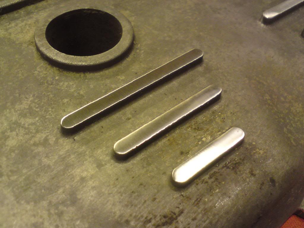

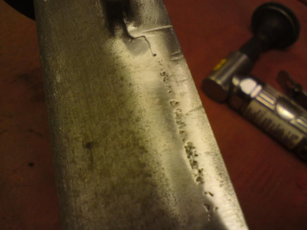

    Ran the mini grinder over the ridges, in case of leaving them unpainted
    Started on the casting marks along the side, little worried about the pitting so was very gentle

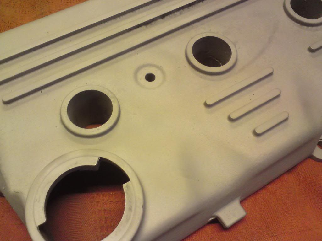

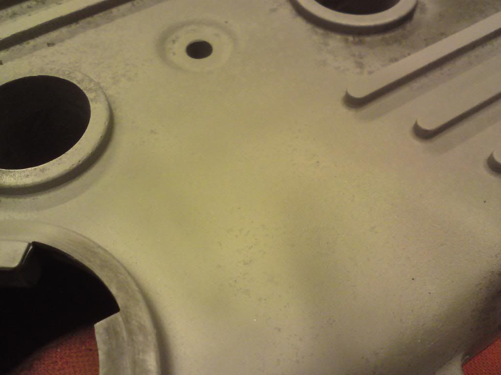

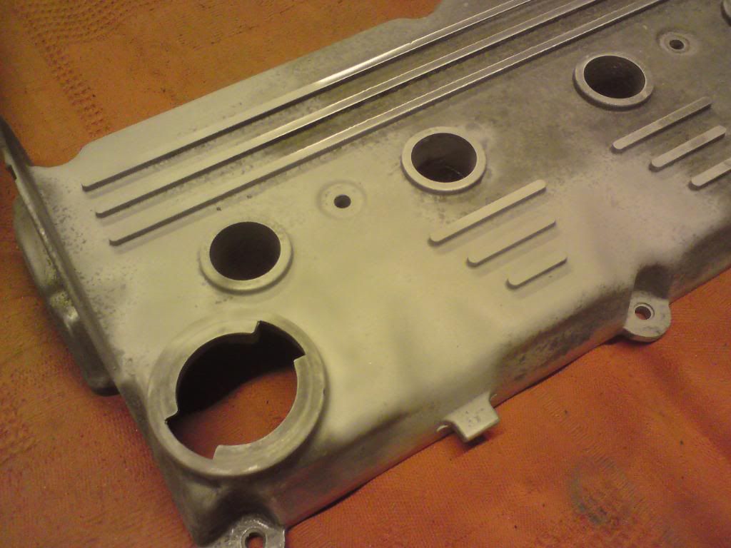

    Did that all round the outside perimeter and started the blasting

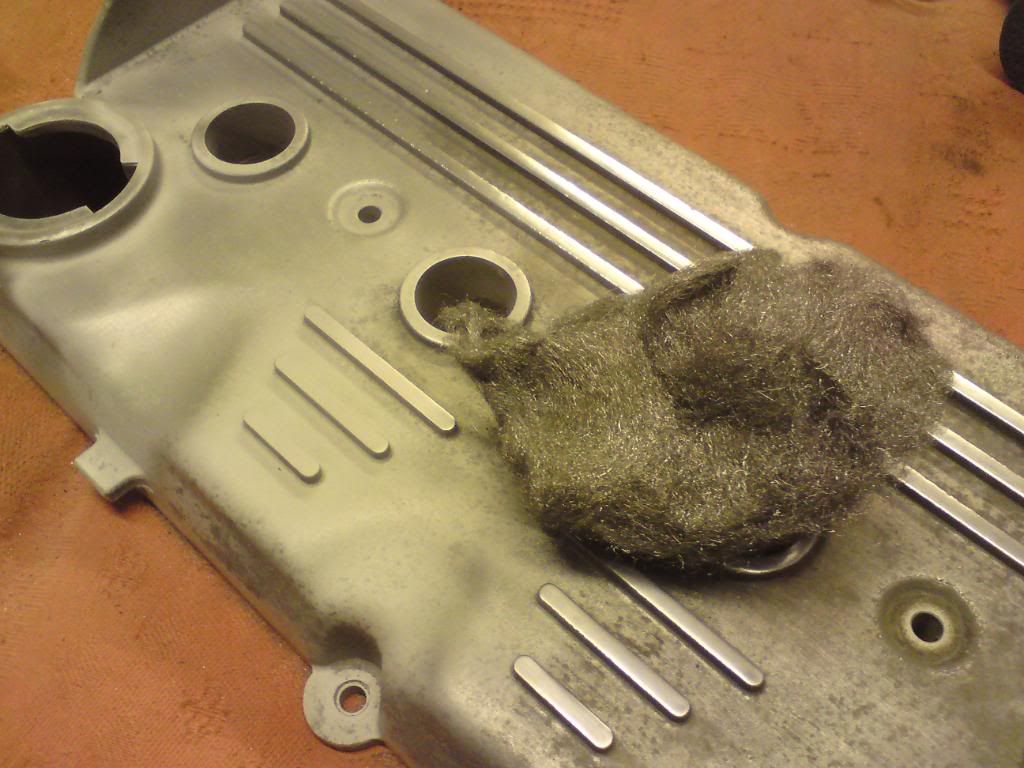

    Came out ok after a quick blower over but found some hard baked on crud that the media wasnt touching. Pulled out some new clean wire wool and used the softest grade to clean up and not leave any marks
    This sped things up well and now looks like this :thumbup:
    Will have another go at it nxt week just to make sure i'm happy, then its all yours:thumbup:

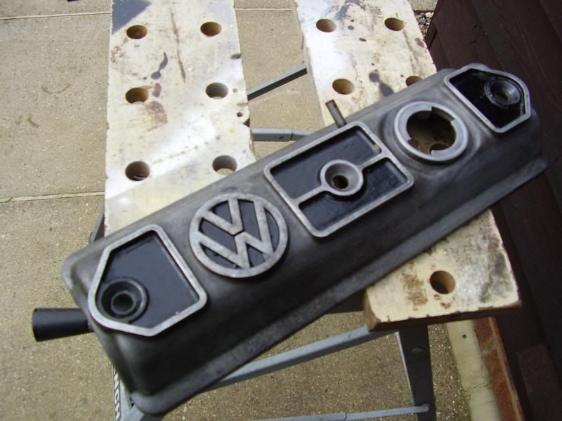

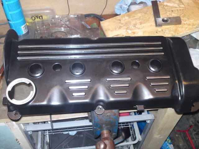

    Here's my effort. Polished raised bits and satin black plastikote.

    I had a tidy up and sort out in the garage tonight, had a quick look at the cover and marker penned some tiny areas that need another go ..... should be done weds night:thumbup:
    Do you want me to give the raised bits another polish ?
  12. A.N. Other Banned after significant club disruption Dec 5th 2
    Great - probably worth a quick once over, but don't go OTT as I may just paint it (unless I can be told how to leave those bits unpainted, whilst using a spray can [:$] ).
    Cracking - I'll be in touch!

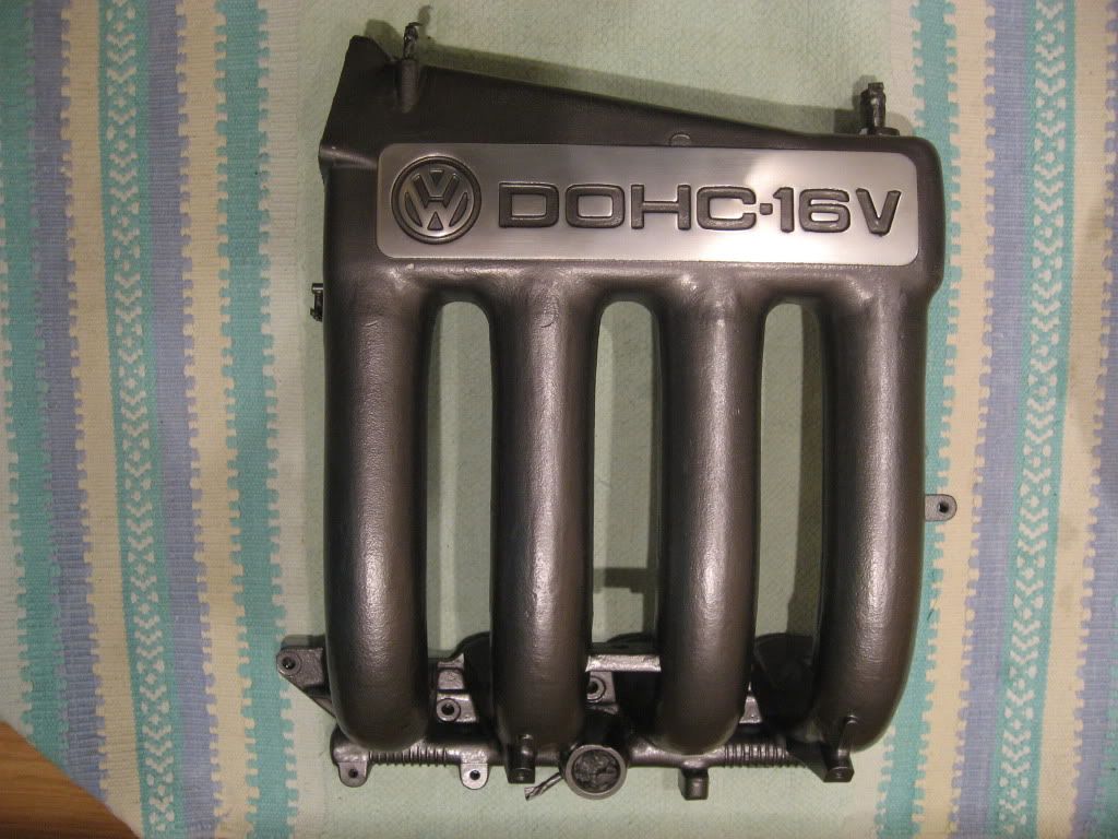

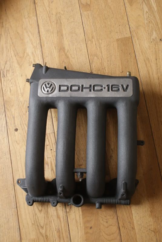

    just done both mine today, cam cover plain with a bit of masking on the inlet manifold
