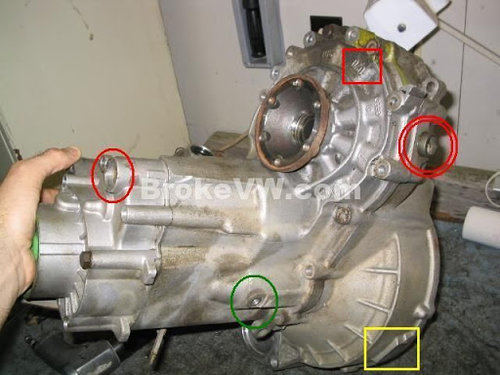

  4. Savagesam
    The yellow box, underside of the gearbox

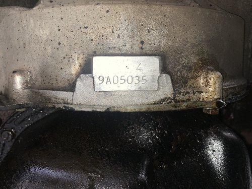

  6. joe98 Paid Member Paid Member
    Dec 4, 2018
    Found this underneath, google brings up no search results. Can anyone help :)
    9A is an 8v box, so you can use mk1/2 1.8 8v 210mm clutch kit :)
