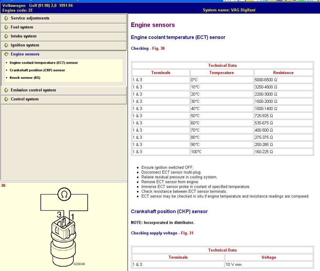

    It`s essential to have a good CTS, mine uses twice as much fuel cold as it does hot. I wouldn`t bother testing the old one, if there`s any doubt change it as a matter of corse. Even if it reads ok without the ecu load it could still missread when connecoted to the ecu.
    Normal vw NTC`s read 6000 ohms 0 degrees and 200 ohms at 90-100 degrees c.
    The 2nd set of pins are probably for the Temp Guage?

  10. rubjonny
    The 2 pin senders are for cars with a seperate ecu & gauge sender, and the 4 pin ones combine ecu and gauge senders :)

    Wow Neo!
    Where did you get this data from. I'm struggling to find out digifant data?

  15. ivork New Member
    Feb 19, 2014
    Aaaagh @Neo - YOU ARE THE MAN!
    Why is this stuff not in the Haynes manual? To protect the VW agents?
    Thanks man. You saved me plenty $$$'s.
    My problem was my wife's Golf was hard to start when cold and had to idle for a while before it was driveable.
    On measuring between pin 1 and 3 with a multimeter in the morning stone cold it told me the resistance was sitting at 1K4 (about 35 degrees)!
    Replaced sensor for a couple of bucks and all good.
    Still peeved it's not in the manual - it is now. I printed out this whole thread and taped it in to my Haynes for future reference.
