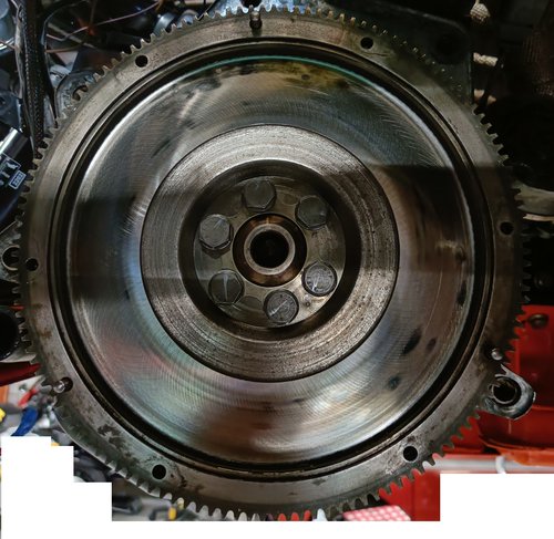

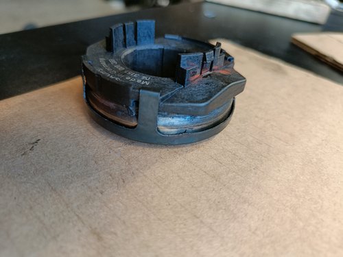

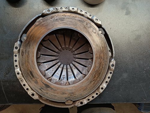

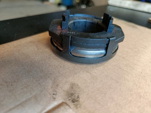

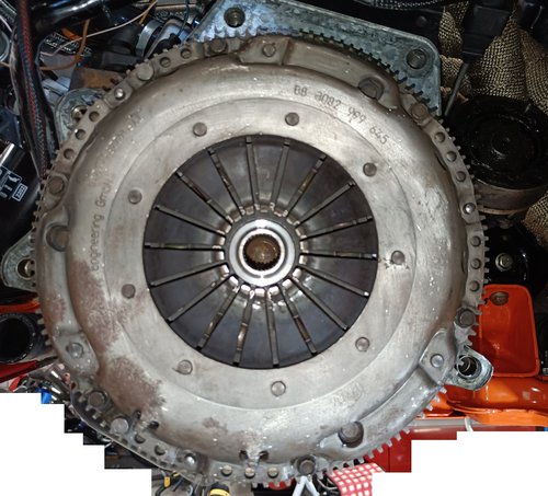

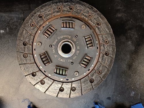

    I can't feel any play on the pressure bearing, but it is leaking grease a bit. I dismounted the clutch and I cannot see anything on that. No broken springs or broken plate.

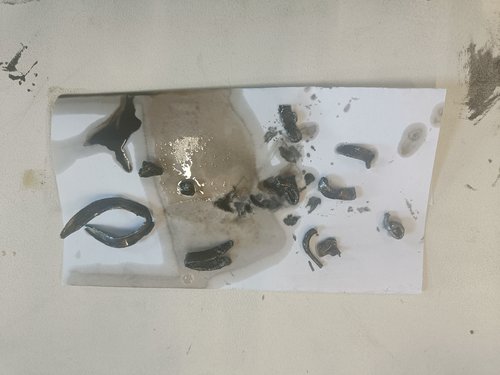

    I do see a lot of damage from the removal. I removed a lot of small steel chips off the flywheels pointy edges and the inside of the gearbox has a lot of spicks in it.
    The flywheel clutching surface has some spots/marks, but none really burned if you ask me.
    So..... I can order a new pressure bearing, no problem. But what if the next one also fails within 175 km? That's a bit fast right?

    Maybe a small note, when mounting everything it was all cleaned but I did not add any grease to the splines, the surface the bearing runs on etc. It was all dry.

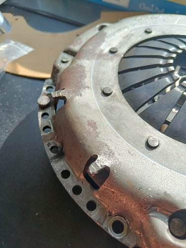

    If you look at these fingers, something has been off. They are damaged.
