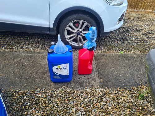

    I use Aspen 4 for storage over winter, it's pure Alkylate fuel with no additives at all.
    Also use it in my garden equipment (what it was made for).
    Very long sorage/ shelf life (years).
    Not cheap but I've got £1000's invested in one cars fuel system so cheap insurance.
    I drained the remains of the fuel out and put 10l of Aspen in.
