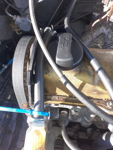

  9. Mk2 driver 1800 New Member
    Jun 2, 2020
    This was how my fuel line was I decided to route it round the engine went out for a drive for 10 minutes and on the way back it just died the only way I can get it to go again is to prime it and take the fuel pipe of and let it sit in a bottle of petrol then when its started I put the fuel line on and it starts like normal weirdly I have to do this tried just priming it and using the bottle trick on it's own but it never works

  11. rubjonny
    fuel pump may be weak, filter blocked or issue on the sender inside the tank. start with the cheap things, move up from there
  12. Mk2 driver 1800 New Member
    Jun 2, 2020
    I've replaced the fuel pump and I've noticed my fuel filters get dirty quick managed about 15 miles before it cut out managed to get it going and I've left the filter of for now does the fuel get drawn through the sender unit to the engine or is it drawn from the bottom of the tank.
  13. Tristan
    It's coming from the bottom of the tank. If you're running without a filter you're gonna choke up your carbs.
    Your tank obviously has gunk in it.
