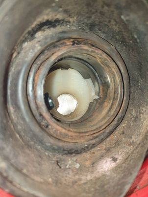

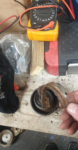

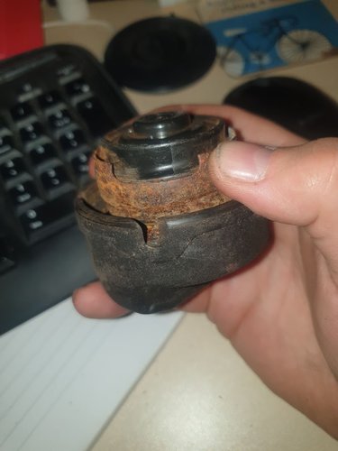

    Has anyone dealt with an issue like this before? My mk3's metal ring that goes around the filler neck and allows the fuel cap to locate has corroded so much it fused to the cap and has disintegrated.
    I can't see on the parts diagram that this part is available so is it really a case of installing a new fuel tank??!

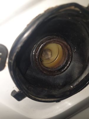

    Last pic is of my corrado where the metal ring is present (but also corroded actually).

    I've got a kaput mk3 tank I can lop the neck off matt if want it, not sure if can swap collars, but here if needed pal.
    Could you remove the old one from your tank by breaking it up as its half off already, then remove ring off scrap neck with heat/burn it carefully and then reinstall on yours by compression or bonding?

    However that said I would still be interested in it I think as i could use it on my Corrado? I'm pretty sure that would work as the cap is the same. I'll have to do some research before you go butcher mode [:D]

    Vaseline around the cap and collar, guy at the old school petrol station near work suggested it as our cap sticks to seal on the green one and my wife can't undo it to fill up.

    dont think mk3 tanks fit corrado, I've heard someone pulled the metal surround off a mk4 tank and it fitted

    Rubjohnny this is for my mk3, it's just my Corrado one doesn't look that much better!
