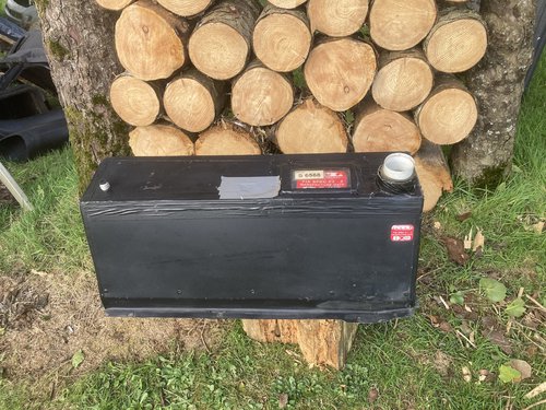

    I am willing to sell the pumps and VWMS tank if anyone wants to make me a generous offer.
