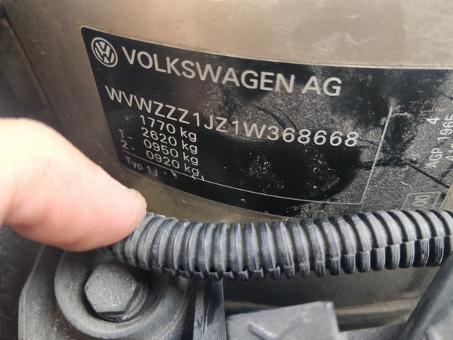

    Is the sdi engine a 1y engine?.
    Isn't it possible to turbo this engine as it has the oil sprayer under the pistons?
    Yes but easier and cheaper to buy a donor and swap parts over

    What do you mean by 1y engine?
    Sorry for the late reply as i had previously given up ...but alas i have faith again haha
