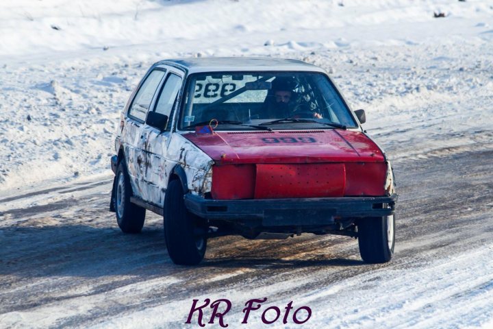

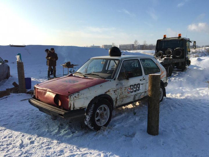

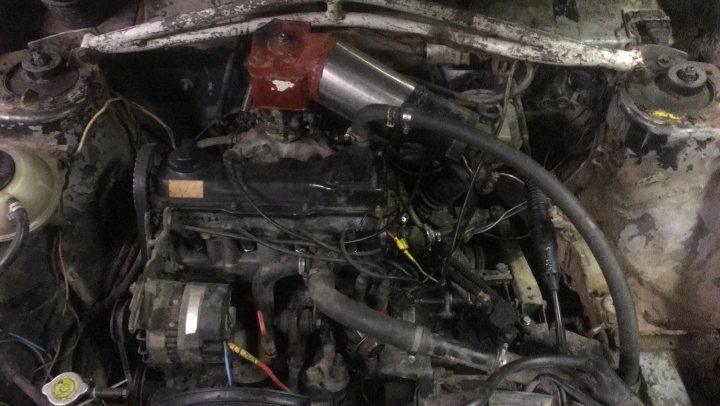

    Hi, thanks for the suggestions and sorry for the late response. Was caught up in things and this is how far I am with the car. Didn't make it on time for the first race with the engine swap so had issues with the 8v. Now trying to get in the 9A and decided to go with the k-jet. Will post an update on how it goes. :)

    [​IMG][​IMG][​IMG] [​IMG][​IMG] [​IMG] [​IMG]
    Some photos
  10. Rakovs New Member
    Feb 8, 2019
    Planning to:
    *9A block and head (everything new inside - gaskets and stuff)
    *K-jet from 2.2 audi 100 also have one from KR engine, but I was told that the one from audi is better
    *4-2-1 exhaust manifold
    *fuel injectors from Saab 2.0t
    *Taking the outtake camshaft, cutting the end of it and placing it as intake camshaft (got suggested by other racers)
    *porting the head
    *50mm throttle body on KR intake manifold
    *not sure what to do with the ignition (electric)
    *not sure where to get a budget ECU that fits this purpose and is adjustable. Is there any stock ECU that is good for modifying/adjusting?
    Any other suggestions? :)

  11. Jon Olds Forum Junkie
    ignition, clockwork. 9 degrees at tickover 36 at 4K plus. Or numbers in that area.
    On a loose surface (from my experience) if the revs drop below 4000, your dead meat.....
