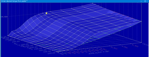

    As an aside, I've also managed to almost entirely "fix" the jerky driving that seems to be present in most V5's. While I was at it, I've improved the flat spot at 4000RPM and made the idle a bit stronger as I always thought it was weak. This was all achieved by recalibrating the ECU, I've tuned EDC15 diesel's before but the ME 7.1 that runs the V5 AQN is quite a complex beast compared to that. So it was a steep but fun learning curve.
    The biggest change I got really was adjusting the pedal maps. Below you can see the top curvd surface is the original map, and the green surface below is my new calibration. As you can see my new "map" is much flatter, so you have to push the pedal quite a lot further to get the same torque. This is totally a preferance thing, and this is what I ended up liking the best. The ECU can also use another map for low speeds, and this kept the original mapping to make pulling away easier without having the floor the car. upload_2022-11-7_0-0-25.png
    The "flat spot" is caused by less than optimal switchover point for the intake manifold flap. There are several factors that can be adjsuted, but initally moving the switchover back 200 RPM made quite the large difference. I need to refine this, and adjust a couple of other maps that relate to load scaling to get it perfect, but its already alot better.
    Idle was improved by playing with torque reserve and minimum timing. When the car idles "normally" it runs at a base timing that is advanced to keep everything efficient. When you try and pull away, you ask for more torque, as the timing is already advanced, the ECU opens the throttle flap to allow more air into the engine. The air actually filling the cylinders takes time, during which you can stall. Torque reserve increase load (air flow) and retards the timing to produce the same output torque. This means, when you pull away, the ECU can instantly advance timing to give you the torque you request. The car has torque reserve already, but its not very significant. I increased this, turned on additional torque reserve at low speed off idle, and allowed more retard to facilitate this higher reserve. I also played around the PID controller for idle, the D term is disabled, enabling it does make the idle stronger, but also causes a slight oscillation. I will retune the whole controller when I have time.
    Finally, a adjsuted the time constant that is used for bringing in the full throttle Enrichment (LAMFA in ME7), this results in the car running richer, faster, which helped somewhat the low/mid RPM knock that is present on these engines. To fully correct this, I need to further review timing as Toyotec has done. These engines are slightly different to the DIY tuners choice of 1.8T in that they have VVT intake and exhaust, and thus has 4 timing maps that are interpolated between. Exhaust advanced/exhaust retarded and no cam overlap to cam overlap. This took a bit of working out, but I now understand how the system works and I can apply my own changes.
