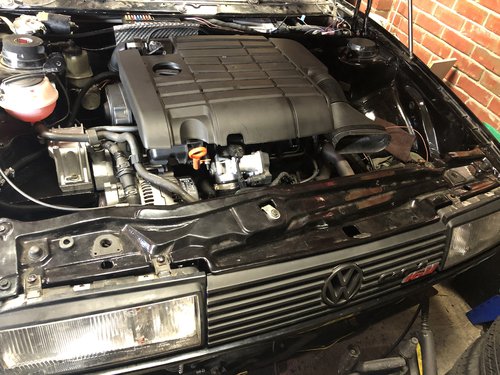

    Dusted off my search skills, maybe I'm a bit rusty as I can't find anything on transplanting a Golf R into a Corrado or a MK2 Golf.
    Could you point me towards anyone that has done it, is anyone in the middle of doing it or are there threads on the go discussing and developing the idea.
    It's a genuine interest, plan to adapt the modern drivetrain along with all the tricks and gadgets into the super cool coupe!

    Thanks for that, it's very early days of research. It would be the EA888 engine and it has to be a manual, adaptive suspension desirable but not vital. Need an almost complete car, with as low miles as possible. Major chassis fabrication, bespoke charge cooler and exhaust and undoubtedly a lot of work.
    There is really good work on the VWROC forum putting an R into a MK1 Golf
