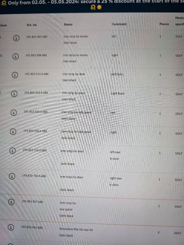

    As VW Classic has a 25% sale on I thought I would try and take advantage and stock up on some parts I will need.
    Trying to get the genuine Gti model trim sticker line that goes around the car. Sounds easy enough, but some refer to it as foil trim and the picture shows a sticker, coiled up, whilst other parts show a perfectly straight item decorative strip.
    I don't want to mix up and get the wrong items...

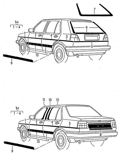

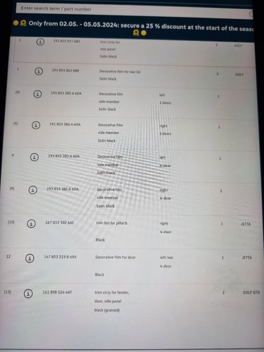

    7Zap has a list, it looks like VW broke down / catalogued the waist strip by it's various individual parts eg. wing / door / side / rear and not as one complete length.
    That'd imply they were pre-cut, perhaps the reproduction coiled up example you've seen just requires you to cut it to the various individual sizes?
    Reading back over the list has jarred something in my memory, it's possible the stip came in grey (for certain body colours) and not just plain old black... so perhaps the same strip, but in a different colour, has an alternative part number that you'd need to be aware of / avoid mixing up?
    I think 'Foil' is a literal interpretation of the German when translated into English and is the same thing.
    https://volkswagen.7zap.com/en/rdw/golf/go/1984-14/8/853-171000/#1
