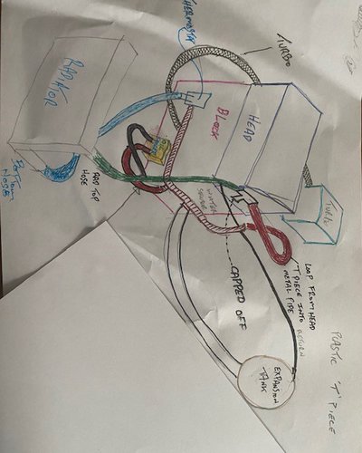

    it's been a while. Question to rack brains over as I am sure we are missing the obvious. The race Polo is coming out of retirement to become a track car. Originally it was the N/A 2.0Ltr engine then in a hurry we through in the 1.8t which was much better. Long story short. It always ran hot, very hot!! I was convinced we had routed a pipe wrong or something, or the flow is wrong. So I would like to see what's what with it once and for all. I will attach a drawing of what's on it in terms of coolants hoses etc and see if one of you can see something. Feel free to shout at me, ask me a question. Cheers for now

    What is hot, oil or coolant?
    What are the temperatures?
    What oil and coolant are you using?
    Do you have an oil cooler or is that the heat exchanger you've drawn as that yellow box?
    The setup you've drawn looks like the standard routing with the heater-radiator deleted.
    My engine (ABF, no turbo) was also running hot, so I changed the radiator to a 3 row aluminium from a Civic (courtesy of TonyB). I now use the Motul Mocool (similar to the red line water wetter people advised me) with demi water.
    I deleted the heat exchanger and added a 13-row oil cooler.
    Temperatures have dropped massively and I need to shield off the oil cooler to get the engine up to temperature (then remove the shield).

    An oil cooler was supposed to have gone on at some point but never did. I presumed it was coolant getting hot as I had it in my head a hose was wrong so the flow was wrong or something. It has a loop (red in picture) which I was never sure about. Correct with the heater matrix delete, don't need it in the race car, hot enough. Always used VW coolant and Castrol oil, same with old engine. Would be good to know correct oil/water temp. Race technology dash just gone in, oil temp/pressure are fitted but awaiting water temp sensor to fit. But pre dash the water temp gauge would go off the scale at one point. So presumed it was a water thing. Got me thinking now.

    Is the thermostat working correctly?
    I see now there is no front outlet like on my ABF/9A/PL engine, but that one is going to the rad and down to the pipe.
    There are 3 loops in my engine(s), all going from pump up through the engine and then
    - front output, down to the pipe, into heat exchanger, parellel into the pump
    - front output, into the rad, back into the pump (via thermostat)
    - side output, going to reservoir, heater rad, tube, return from heat exchanger, then to the pump
    Your engine still looks like the pump is pumping the coolant up in the engine and then returns on the outside.

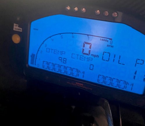

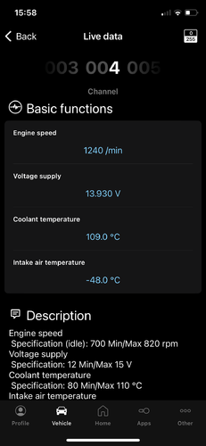

    Thermo seems ok, top hose warm before bottom but then both gained temp together, i let it sit and it got to 110 degrees on OBD reading off ECU and dash showed 99 oil temp before I cut fan in (which is on a switch). cool.jpg cool2.png

    Coolant temp seems a bit high but you're not driving.
    Oil is very oke but again, you're not driving and using the engine [:D]
