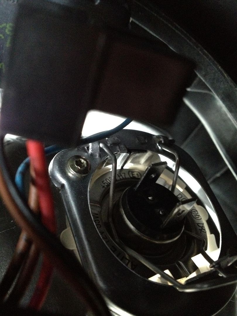

    515
    London / Bucks
    Seen as this has been asked lately, and the only information on the net is to remove your front bumper and headlight [:s], ive decided to do a step by step guide to help anyone who finds themselves stuck when changing the dipped beam bulbs on their Mk4's.

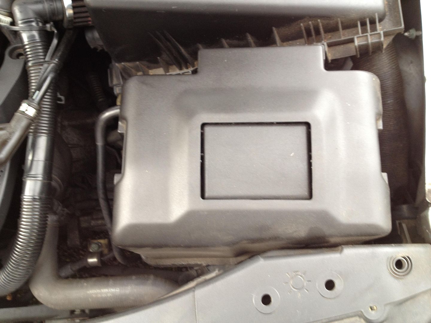

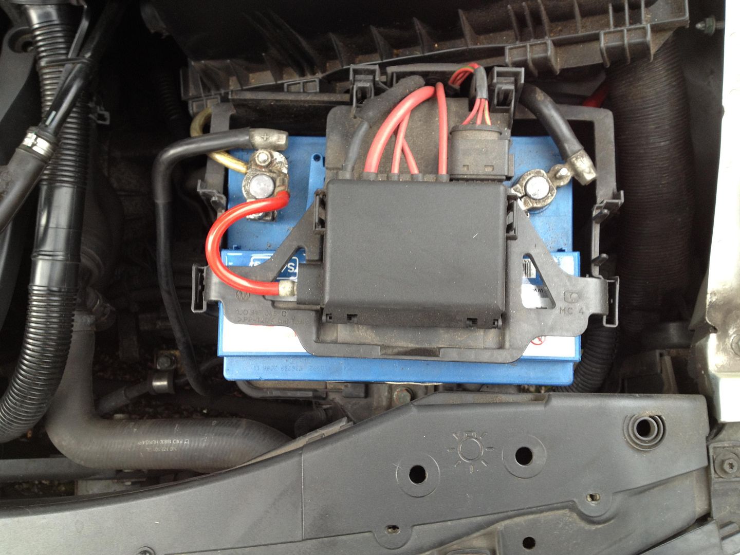

    2. Next thing, remove the plastic battery cover which will give you more room. There are 2 tabs on either side. Just push these in and pull the cover upwards to remove.

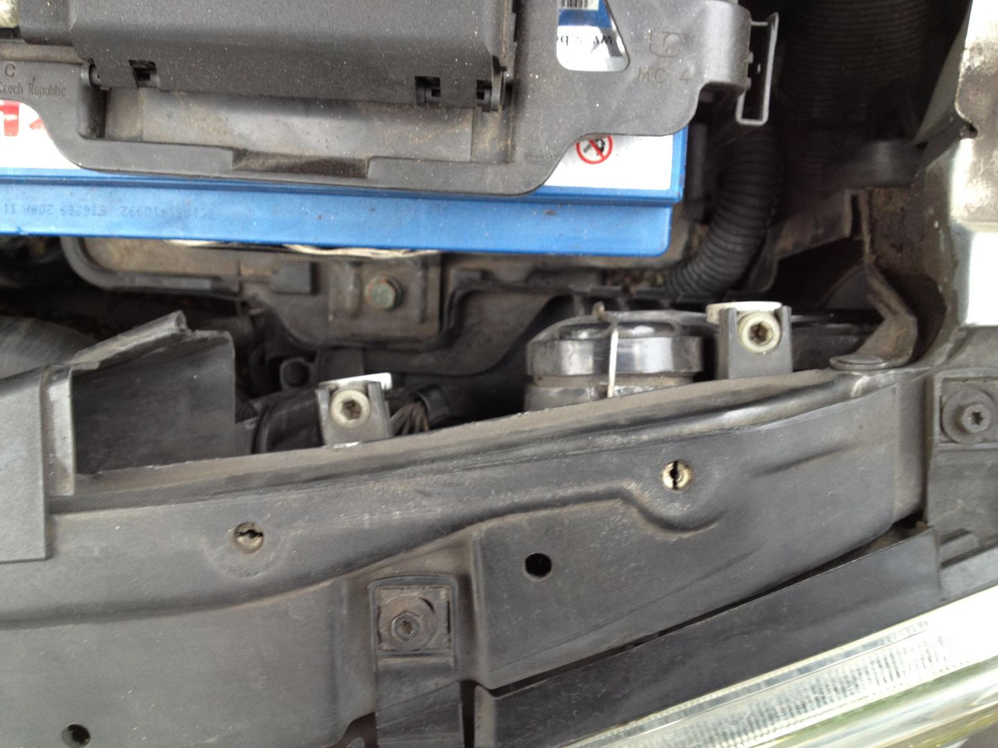

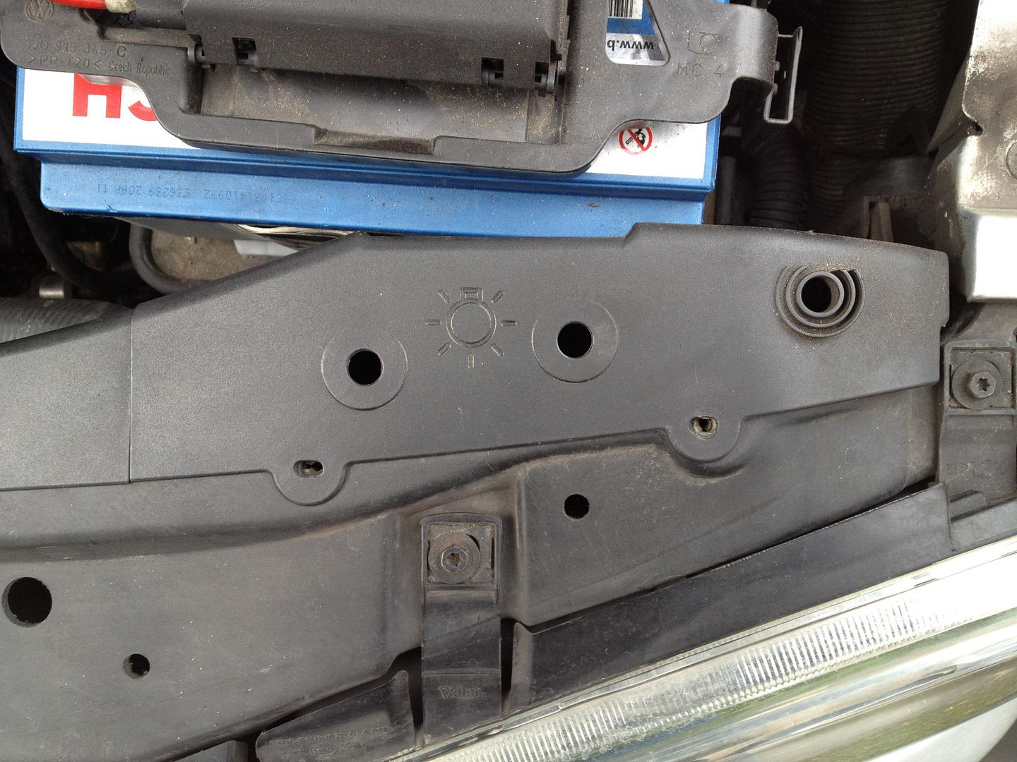

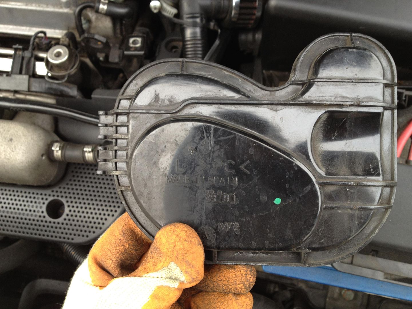

    3. Now remove the rear headlight unit cover, which is held on by two screws. This just pulls upwards, the same as battery cover.

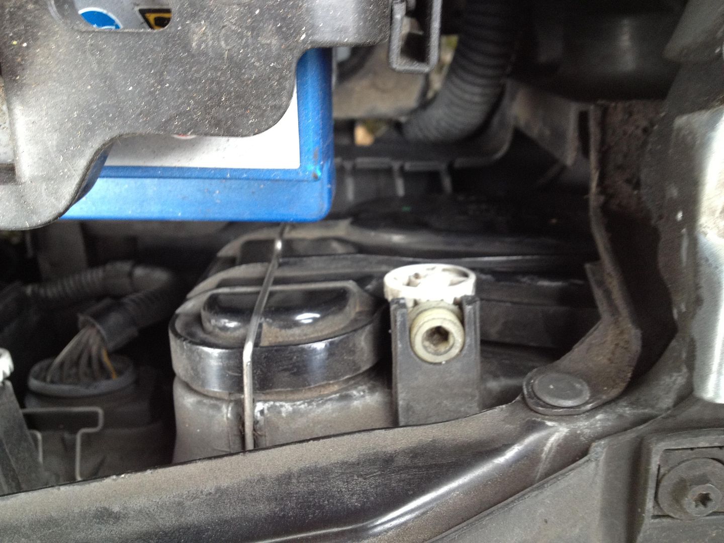

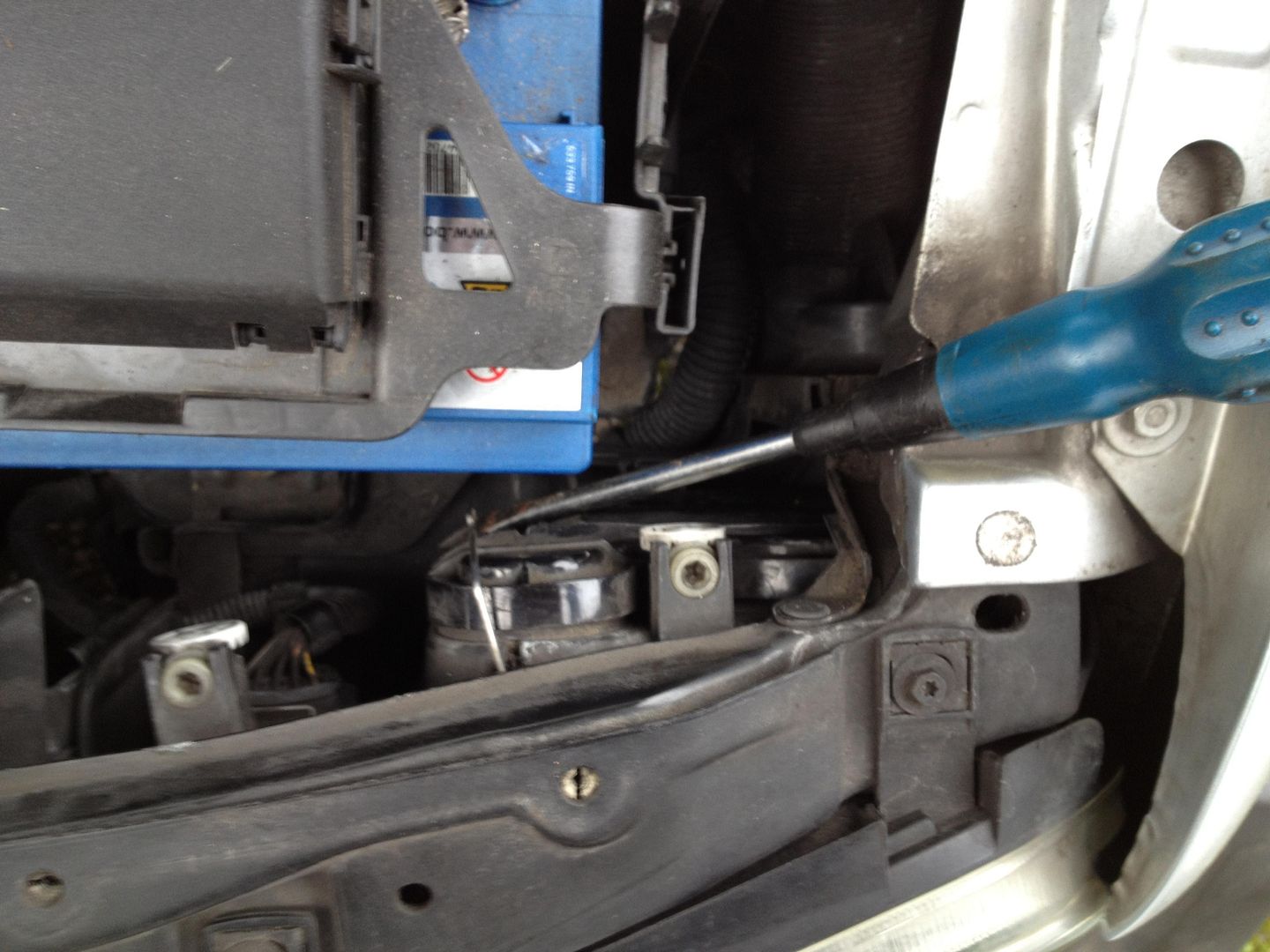

    4. Now you'll see the back of the headlight and a black casing which is held on by a metal clip. I used a screw driver to prise this open and its quite tight.
    Once the clip is free, give the casing a wiggle and it will just pull out. Quite fiddly.

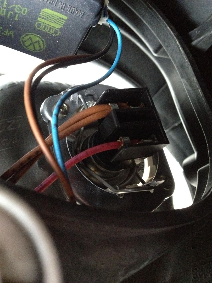

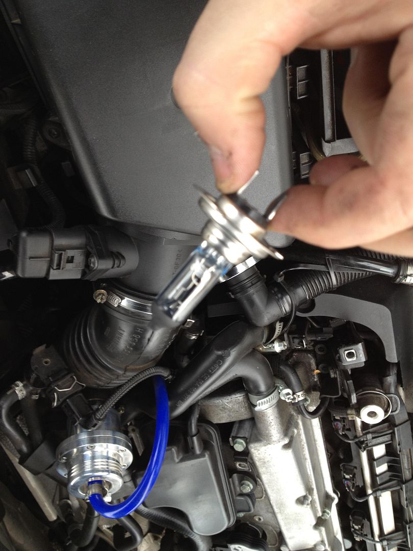

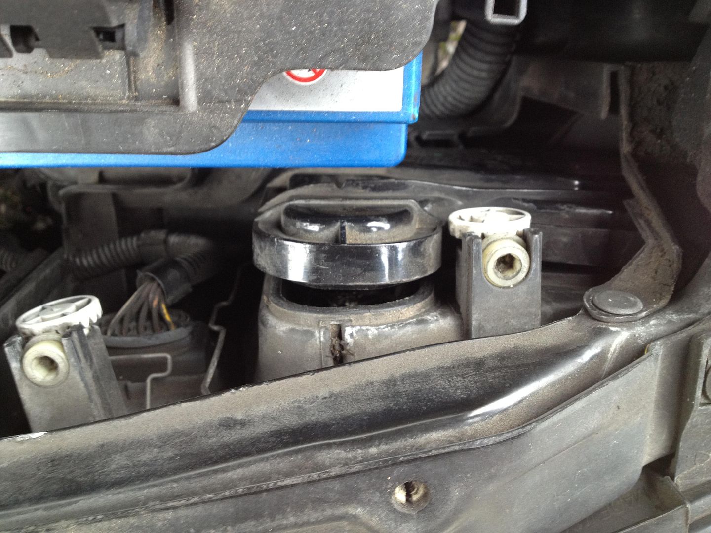

    5. Now you have access to the rear of the light and the bulbs. As you can see, the bulb connector block will need to be removed first, as with any car.
    You then need to un-clip the metal clip which holds the bulb in place. Its really easy to remove and only hooks on in one corner, as seen in the pictures.
    6. Remove the bulb, and place the new one in, making sure you have put it in the correct way and secured it using the metal clip.

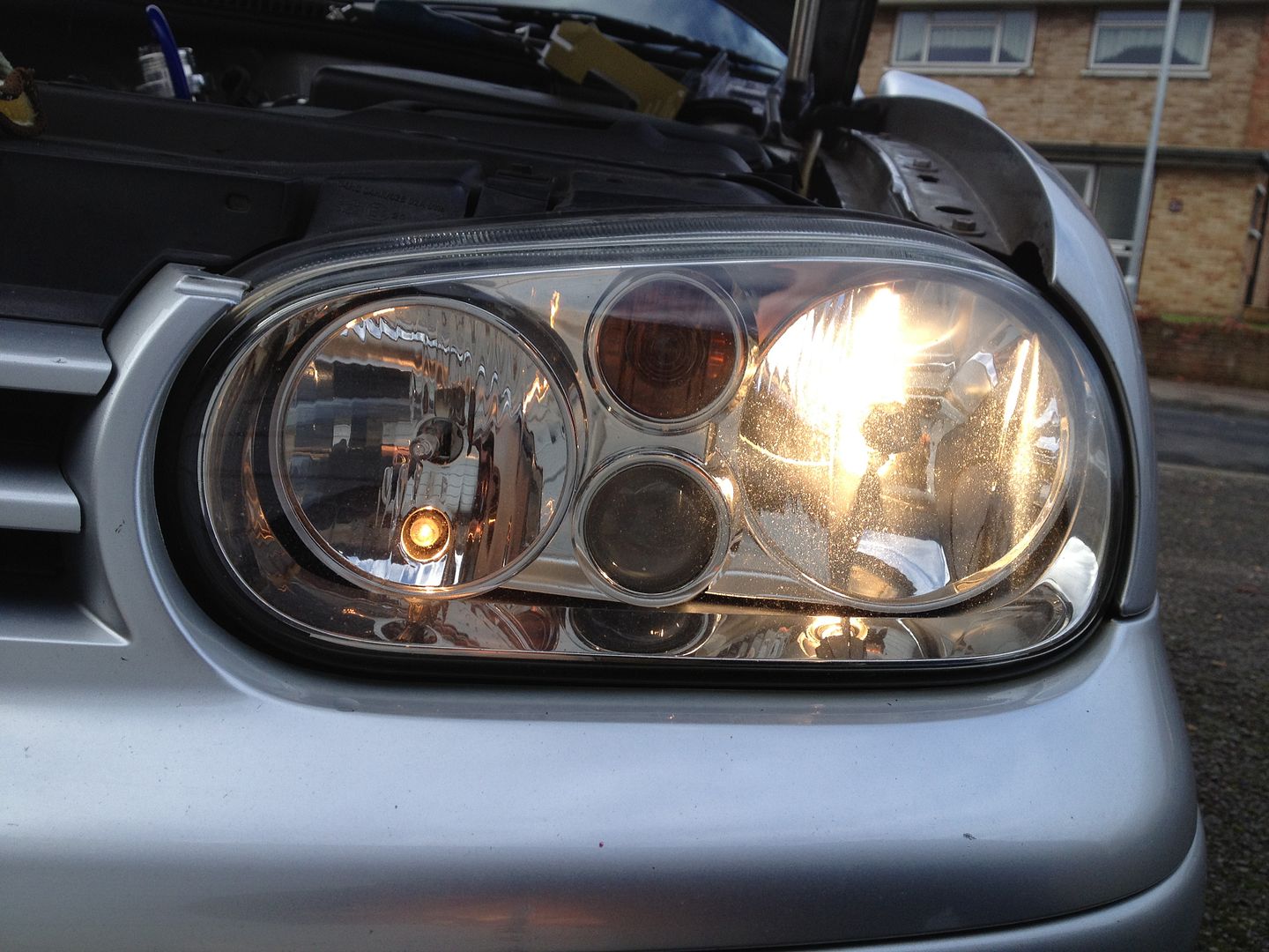

    7. Fit connector block back in place, replace the headlight rear cover and the other cover with the 2 screws, and put the battery cover back.
    Done :)

    I managed to do mine with the battery in place.
    As per pictures above, once the battery cover is removed there seems to be plenty of room to get the bulbs out.
