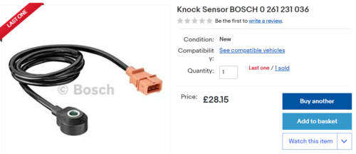

    On the front of cleaning things up, I noticed my knock sensor has been quite 'knocked' around.
    I reckon it is as old as the car 215k/31years time for a change.
    The bolt has rounded, due to rust, does it ever snap off? and leave a stud in the engine block, hoping not.
    Knocked off plastic surround:
  3. rubjonny
    give it lots of penetrating oil and go easy, you should be fine. mk3 golf knock sensors will do you, i nicked one off an audi in scrappy back in the day
    blu-tak likes this.
  4. blu-tak Forum Member
    Jan 29, 2021
    It came off easily actually, its' only supposed to be torqued to 20nm
    New knock sensor fitted - this bosch one has really nice shielded cable.
    I made sure I got the 8v 540mm length one. (054 905 377 G)
    I understand longer ones are ok.
    Mototronic seems a good ebay seller and actually replied to ebay messages
