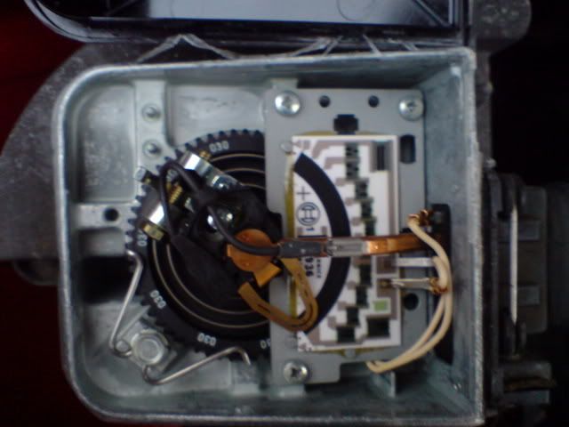

    Agree with wcrado, I was out playing with the AFM tonight. Here's what you'll see when you open it up.
    phonecam so not a great pic.
    I didn't think my car was down on power, it made 113bhp and 127lbs last week which isn't bad for a 17yr old car with an exhaust and an unproven chip. BUt recenty I just felt it was lacking a bit of responsivness.
    I moved the spring out that engages the wheel with my finger (just as carl loader says, no need to undo the 7mm screw) carefully moved the wheel anti-clockwise 3 clicks and to cut a long story short it now drives like a K-Ket :lol: Much smoother at part throttle and alot more responsive. Took it for a quick spin roumd the block and I can't believe the difference. :thumbup:

    cheers for the photo, I wasnt sure what to expect when i open it.
